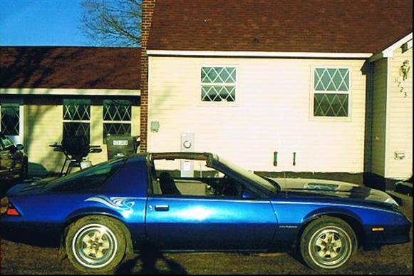

http://my.core.com/%7Eczeck1/ladyluckhomecomming.jpeg

PS
Yes, those are white wall blizzak snow tires in the rear. Also yes, those are Oldsmobile rally wheels. It did have 16" IROC wheels but they were stolen and the car left on blocks. My buddy's dad runs a junkyard, which is how I got this car. That past owner who outsmarted the computer got upset and junked the car. (it was GM's fault it hardly ran, and not his stupidity, or so he says)
The wheels were stolen off it, so Keith was kind enough to loan me the Cutlas wheels till I found some plain steallies to roll it around on.
