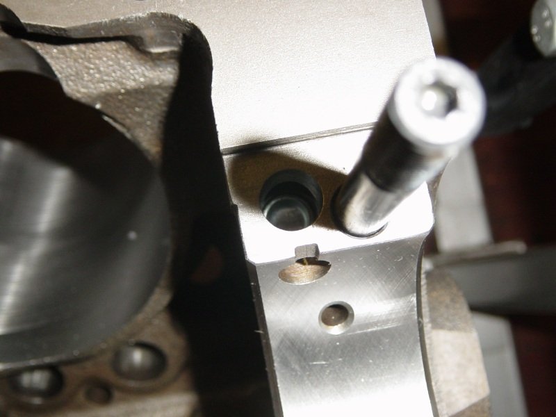

I did make sure to install this plug under the main cap:
http://www.ellweinengines.com/KingERE3/oilgalleyplug.jpg
I put the plug 1.450" from the surface of the block to the center of the plug down in the hole.
when I pulled the motor appart for the rebuild I found that the pickup was off. It has a very loose fit. so I ordered a brand new one and used the correct tool to put it in. it was a very very tight fit. so I would have to think thats not the problem. but to be posative I can pull the drain plug and stick my little camera and light in there and check.
