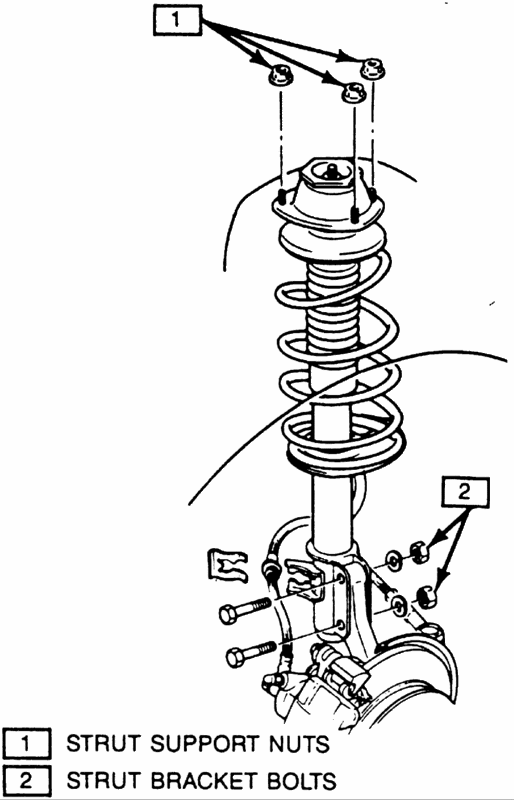

Front Strut Change - 1989-1994 Geo Metro - As shown in these pics and description below:
Note: All Nuts and Bolts are Metric sizes.
1. "Slighty" loosen (Dont Remove) all 8 lug nuts on the front wheels of the car, Then raise and support the front end of the car with jack stands and chocks on the rear wheels, Open the hood of the car.
2. Remove all 8 lug nuts and the front tires.
3. Remove the metal clip that holds the brake line to the strut bracket.
4. Place a floor jack under the bottom of the control arm on the side of the car you are working on to support the lower control arm, slightly jack it up, just enough to take the weight off of it.
5. Remove the 2 "Strut Bracket" nuts and bolts (#2) that hold the strut to the spindle Assembly.
6. Lower the floor jack slighty, just enough for the strut to clear the spindle mount that it sets in.
7. Now loosen all 3 "Strut Support" Nuts (#1) that hold the top of the strut into the upper shock tower under the hood.
8. Now either grab ahold of the strut spring inside the wheel well and slighly lift it up to take pressure off the nuts on top, or have an assistant help you and hold it up while you take all 3 nuts off the top, then lower the strut down and take it out from the wheel well.

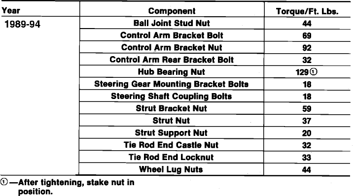

This pic below is an exploded view of the strut assembly. As previously stated, you'll need to rent a "Strut Spring Compressor"....They go on both sides of the strut coil spring and you crank them down evenly to take the pressure off the spring, and unscrew the center nut (#1) of the strut that holds the whole assembly together......Assembly is the reverse of this process. Remember to position the coil spring back in place the way it comes out of the strut assembly (Indexing it)....In other words, make sure the coil spring is sitting in the same position in the new strut pearch, and in the same positon it was sitting against the rubber strut gasket (#13) before you reassemble the new strut assembly. Torque all nuts to the proper specs in the list below with a torque Wrench (Wheel Lugs included)!

Suspension Torque Specs
