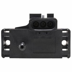

Autozone says your MAP is here:
Under hood, passenger side, upper engine area, mounted on air filter housing
Locate it, follow the vacuum line, see where it goes and what kinda shape its in. MAP looks like this
