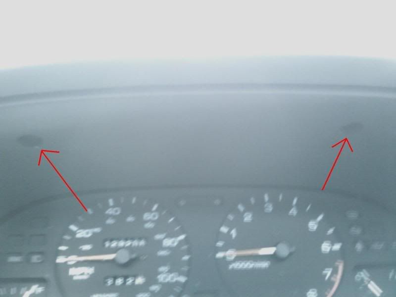

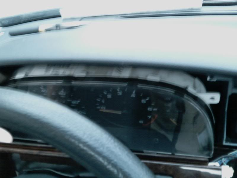

Start with the two screws just above the meters:
http://img.photobucket.com/albums/v388/yashingo_G/97%20Altima%20-%20Dash%20and%20CEL/IMAGE_093.jpg

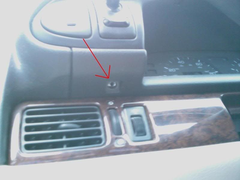

One screw just under where the dimmer control is:
http://img.photobucket.com/albums/v388/yashingo_G/97%20Altima%20-%20Dash%20and%20CEL/IMAGE_094.jpg

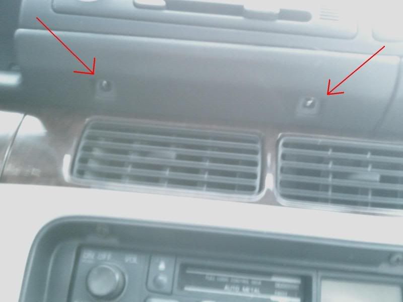

Two screws from just above the middle vents:
http://img.photobucket.com/albums/v388/yashingo_G/97%20Altima%20-%20Dash%20and%20CEL/IMAGE_095.jpg

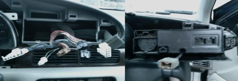

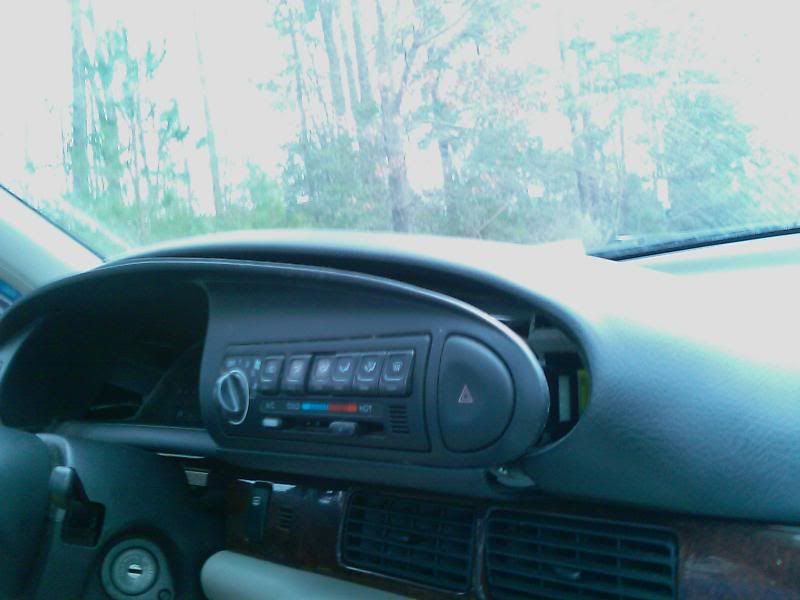

Now you can pull out the top part of the column.
http://img.photobucket.com/albums/v388/yashingo_G/97%20Altima%20-%20Dash%20and%20CEL/IMAGE_096.jpg

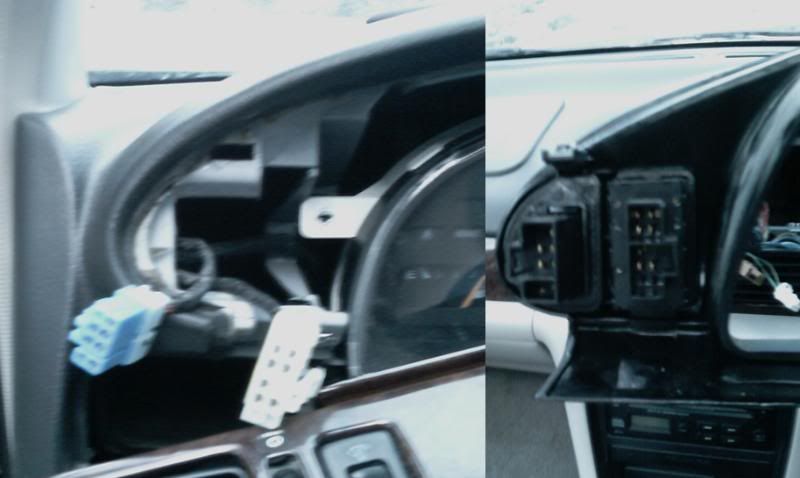

There will be some things to unplug on this column. You'll have 6 plugs on the right side and 2 on the left to unplug.
Left Side:
http://img.photobucket.com/albums/v388/yashingo_G/97%20Altima%20-%20Dash%20and%20CEL/DashandPlugsL.jpg
Right Side:
http://img.photobucket.com/albums/v388/yashingo_G/97%20Altima%20-%20Dash%20and%20CEL/DashandPlugsR.jpg
I had to flip my images around to be able to give you the "side by side" shots you are seeing, but I think you can put two and two together to make 3....er..uh...

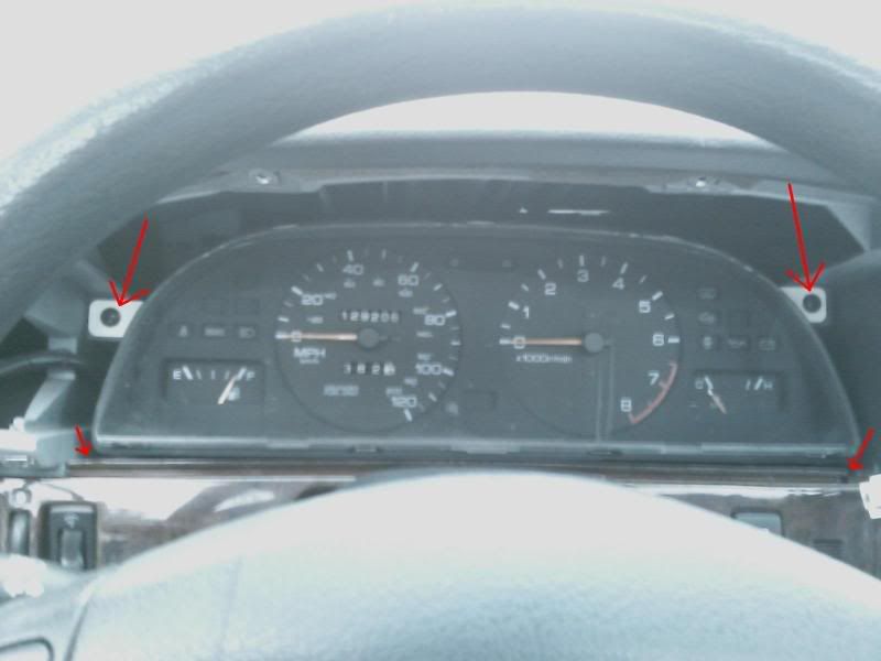

This will expose your meters. There are 2 screws that you can easily see at the top of the harness and there are two that are covered by the paneling at the bottom of the meters.
http://img.photobucket.com/albums/v388/yashingo_G/97%20Altima%20-%20Dash%20and%20CEL/IMAGE_103.jpg
Pull out the paneling. You can unplug the things holding it in, but you dont have to. I chose not to remove it. Just pull it out enough to get to the two screws at the bottom of the meters.

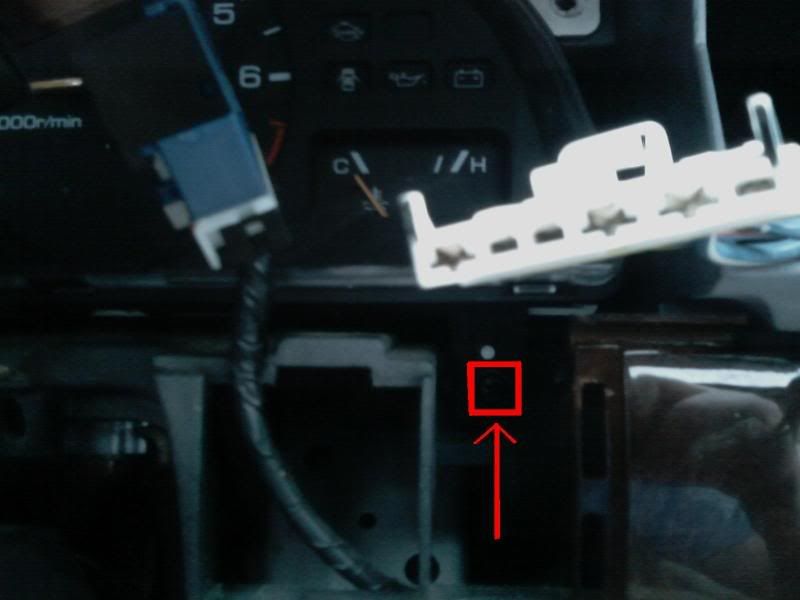

http://img.photobucket.com/albums/v388/yashingo_G/97%20Altima%20-%20Dash%20and%20CEL/IMAGE_104.jpg

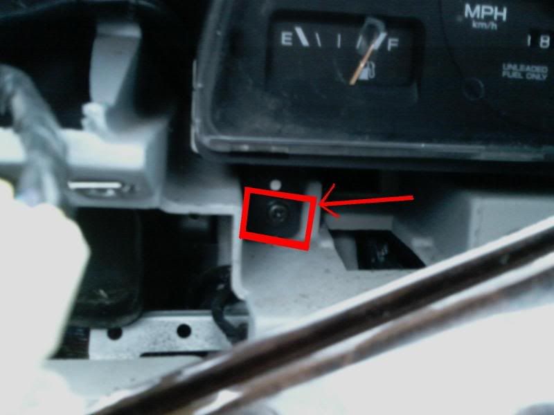

Remove the two screws, one on the bottom left of the meters and one on the bottom right.
Left:
http://img.photobucket.com/albums/v388/yashingo_G/97%20Altima%20-%20Dash%20and%20CEL/IMAGE_106.jpg
Right:
http://img.photobucket.com/albums/v388/yashingo_G/97%20Altima%20-%20Dash%20and%20CEL/IMAGE_105.jpg

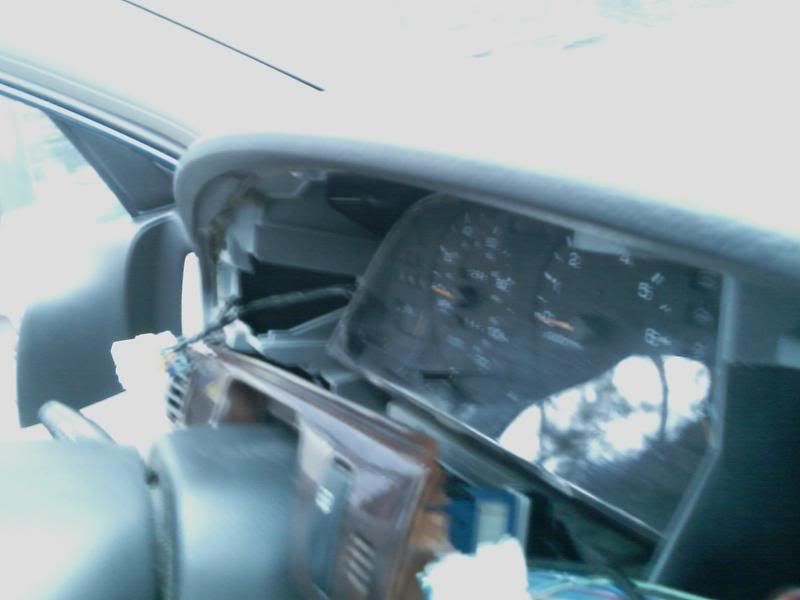

You can now slide the meters out and gently flip it facing down. I chose not to unplug the whole thing since all I needed to do was change the CEL.
http://img.photobucket.com/albums/v388/yashingo_G/97%20Altima%20-%20Dash%20and%20CEL/IMAGE_110.jpg

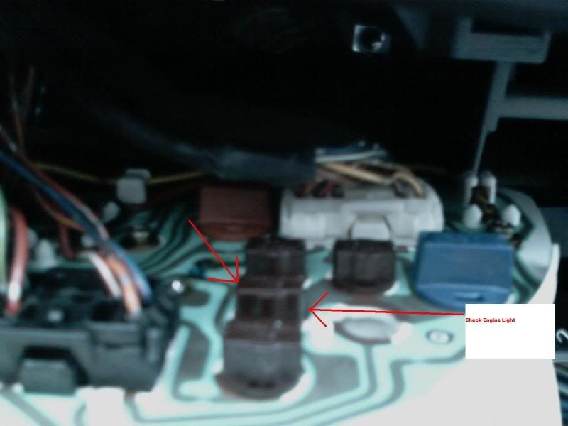

The CEL is on the right hand side of the steering wheel, one row from the top directly under the top bulb (which is the rear defroster bulb).
http://img.photobucket.com/albums/v388/yashingo_G/97%20Altima%20-%20Dash%20and%20CEL/IMAGE_108.jpg
Just give it a slight twist to the left and it will come right out.
http://img.photobucket.com/albums/v388/yashingo_G/97%20Altima%20-%20Dash%20and%20CEL/100_0193.jpg

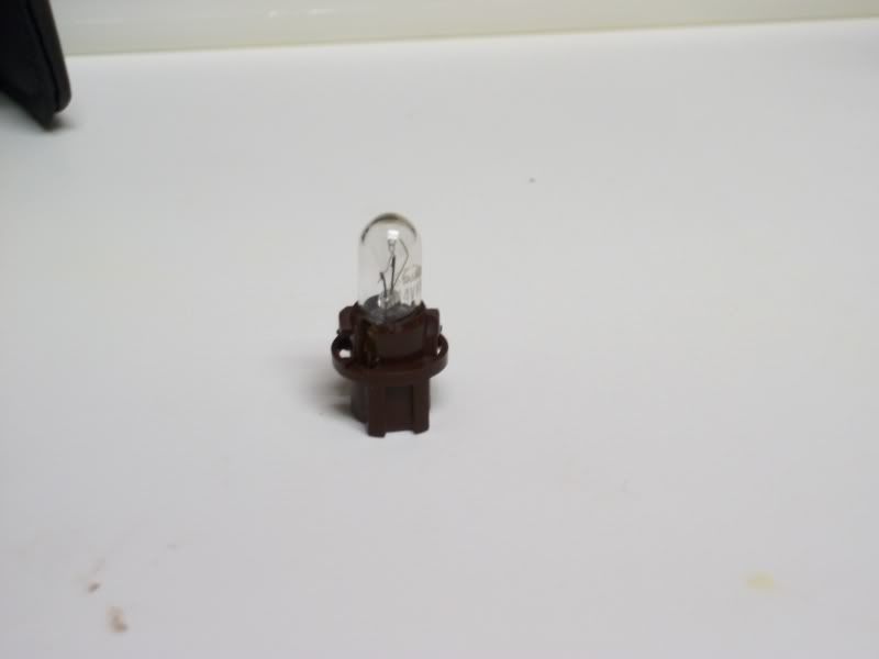

This bulb ran me $21 at the Nissan Dealer, but I'm sure if I had time, I could've found it much cheaper online. The bulb is a Toshiba A14V 1.4W. This is the same bulb used in my 94 G20.
So, place the new bulb in it's home, give it a slight twist to the right and turn your key to the "ON" position without cranking to make sure the CEL shines brightly. Hopefully once you actually crank the car, the CEL doesn't shine at all. Do these steps in reverse order to button everything back up and you will be ready to ride. It should take no more than an hour. I was pleasantly surprised at how easy this was. Good luck!
