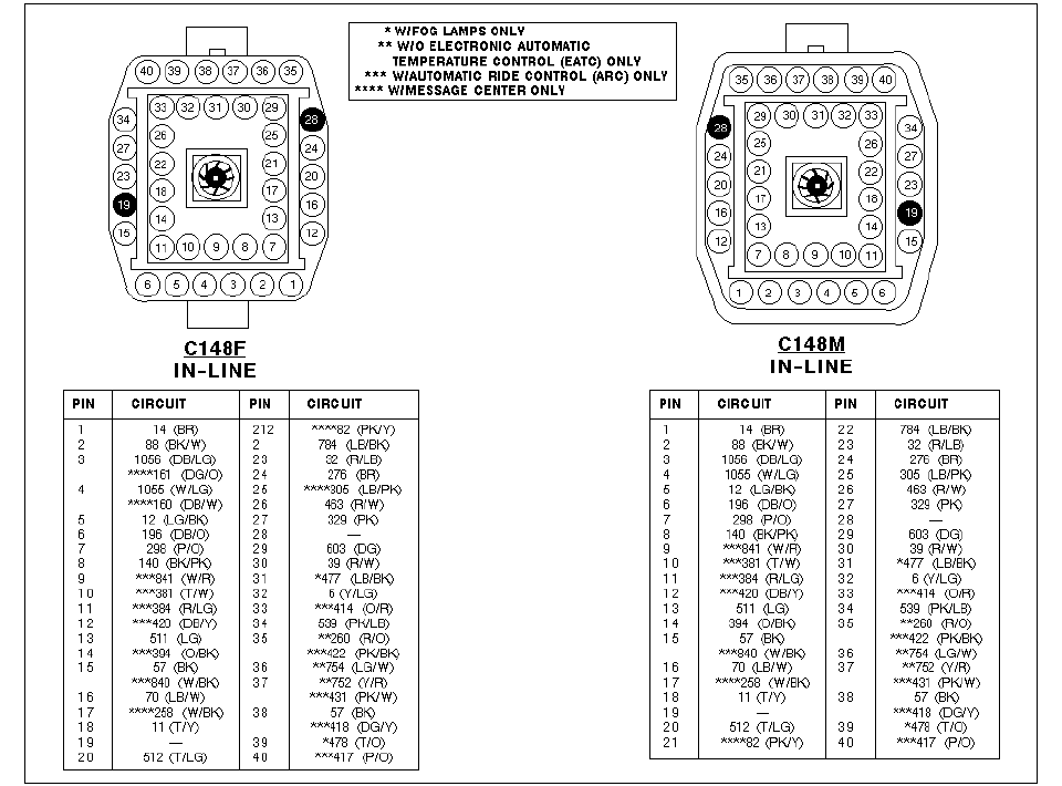

I a have a '96 Explorer, Eddie Bauer, 5.0, AWD. My driver side, low beam light is not working. I changed the lamp and still not working. I checked the socket with a multi-meter and found that I am not receiving any voltage to this side. The right side is OK. #4 Fuse is good as well.

I don't think it is the LCM. You need to trace the wiring to see where it is losing connection. See if you can find the connection below and look at pin 5. That is your left low beam.
http://i153.photobucket.com/albums/s214/way2old1/explowbeam.gif
