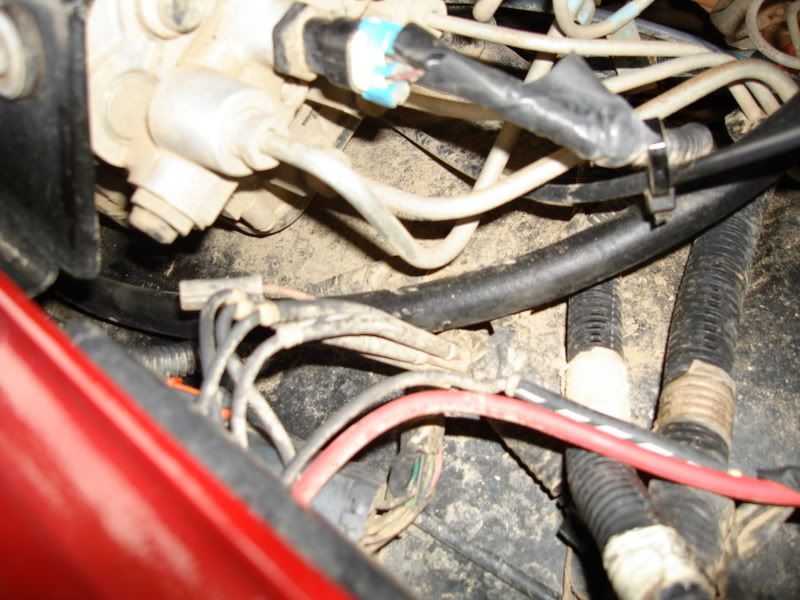

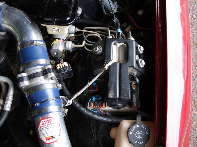

Sorry to those who may want this to stop comming up. But after about a year of wanting to do this i went ahead a bought everything last week and had free time to do it. I poped it in started up and everything was fine it idle fine no problems, yet atleast. Im really looking forward to see if there is gunk that gets deposited in there. I have a new jasper motor so it shouldnt be that bad but im sure ill see some somthing. Any way i posted some pics b/c well they never hurt and could help who ever is thinking about it. tell me if you guys see somthing i dont. thanks
http://i42.photobucket.com/albums/e319/eslhockey92g/Picture015-1.jpg
http://i42.photobucket.com/albums/e319/eslhockey92g/Picture018-1.jpg
http://i42.photobucket.com/albums/e319/eslhockey92g/Picture016-1.jpg
http://i42.photobucket.com/albums/e319/eslhockey92g/Picture014.jpg
as you can see i ran from the pcv right to the can, than around the abs thing and back to the top of the intake. I need to get longer clamps or i will make a bracket to hold the can better. but its good for now. I wasnt sure if the length of the hose will be a problem i hope not its about 5 feet long and i think that the long curve will be ok.

shorter the hose length the better, system is more effective that way. where did you mount the catch can( cant really see it in the pics)? i hung the can off the wiring harness near the wiper motor. i ran the line up under the master cylinder, over the brake booster, to the can, then from the can right to the manifold. my pics are in post 113 or somewhere close to that. i may even change to a hose going straight up from the pcv to the can. you really don't need the hose clamps on there. i've had this installed since september when i got my truck and have not had any problems.

im running right from pvc to the can mounted under the brake booster, on that brake line distributor thing. than from there it wraps around the ABS system right in to the manifold. i was trying to see if there was a smoother was to run everything w/o any aggresive kinks but i did feel confertable in some of the positon. Oh an by the way i have accumlated about a 1/4 inch of oil and what not in the bottom of mine already:eek2:

yea when you first install it you will accumulate alot of stuff but from then on it fills very gradually until you decide to empty it. mine has never really gotten over half full. i might shorten up the hose from the pcv to the can and see if that make the system more effective.
Eslhockey92g
06-18-2007, 11:25 AM
o ok kool that what i was thinking, yeah mine is only about foot and a half tops from the pvc to the can. it goes stright to the can having some slack for engine movement

It looks like he rotated the hard plastic tube from the intake that previously went to the PCV valve, and now the hose connects to that tube. The connection appears to be hidden by the filler pipe, and not connected to the filler pipe itself.
It has to go to the intake, not the oil fill tube.
Your setup will do nothing other than impregnate the oil with fuel and raise crackcase pressures.
All you did was install a pointless loop.
