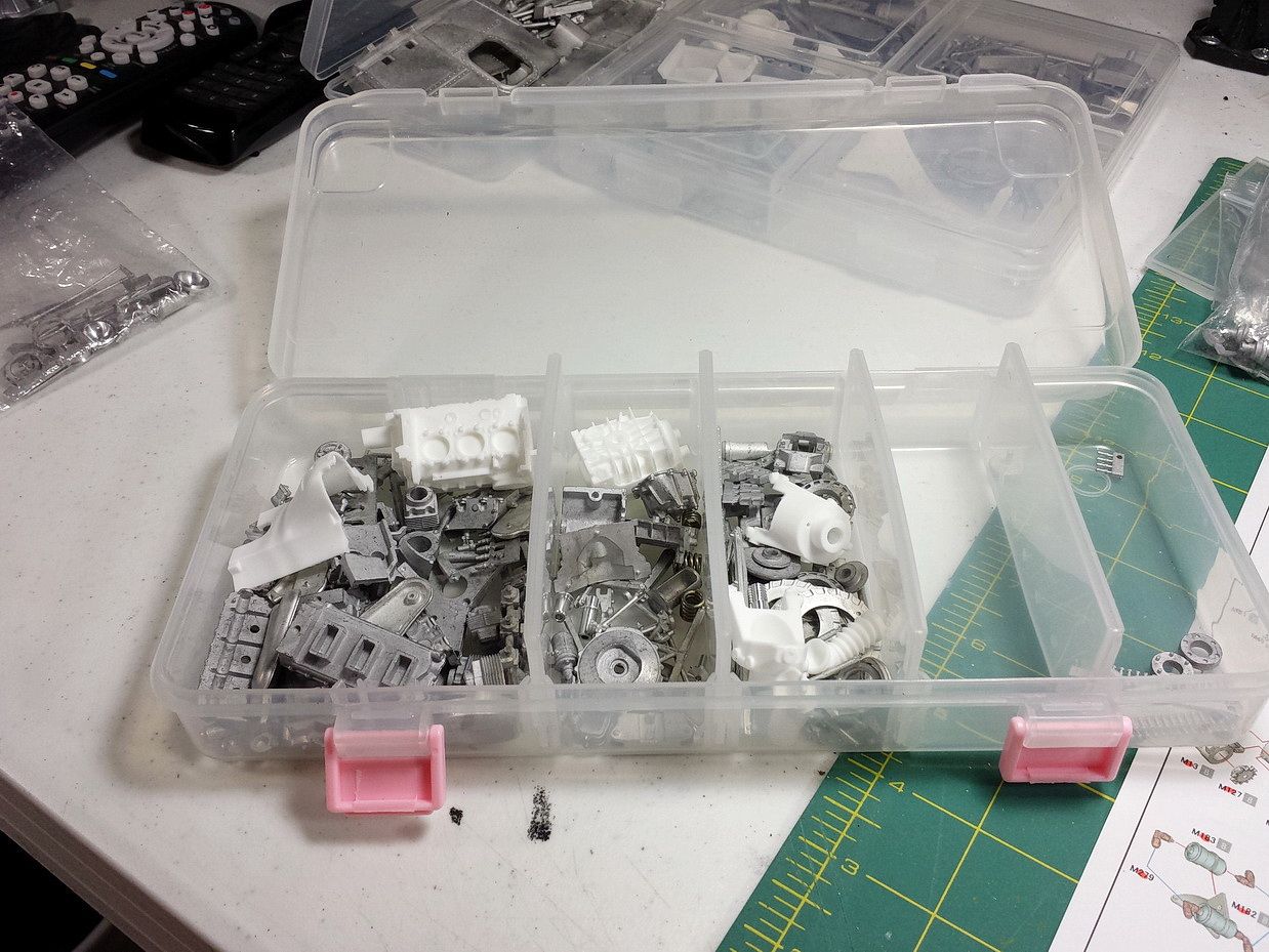

I started off by sorting the white metal parts by assembly sequence so I would have all the parts needed for each step without having to sort through various bags of parts to find the one part I need when I need it.
An example of how I sorted and stored the parts in containers. (Note: There's AF member, Veyron's, built Lamborghini in the background photo bombing my picture :wink: )

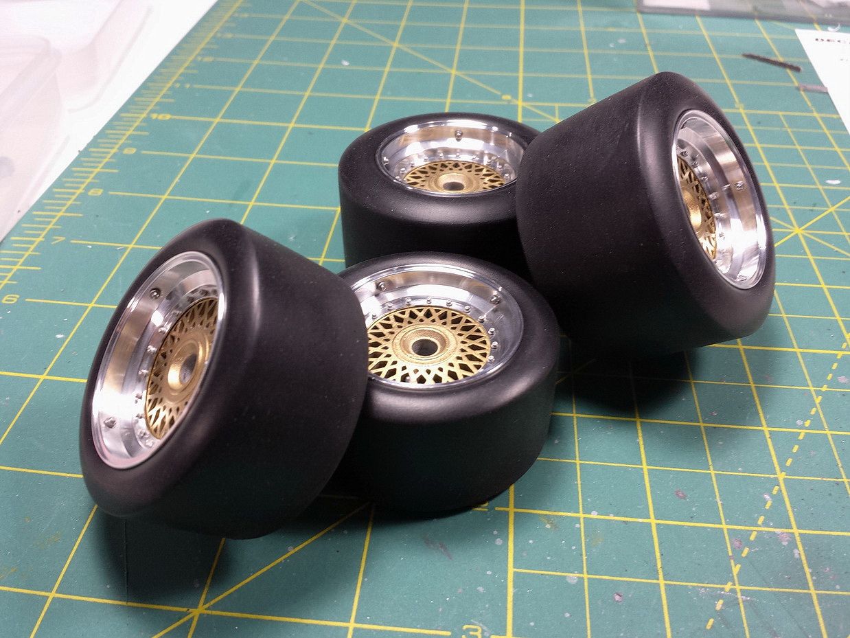

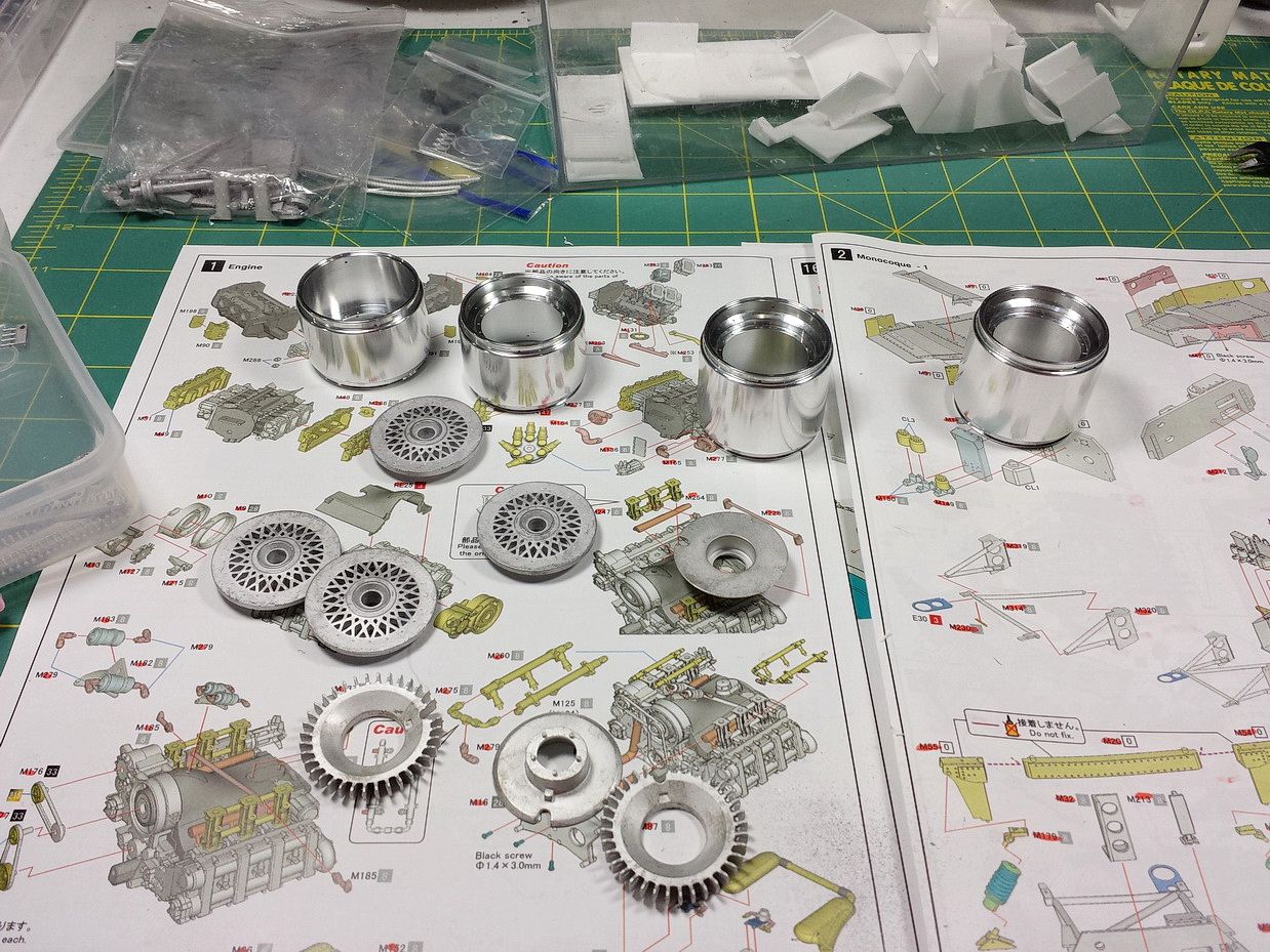

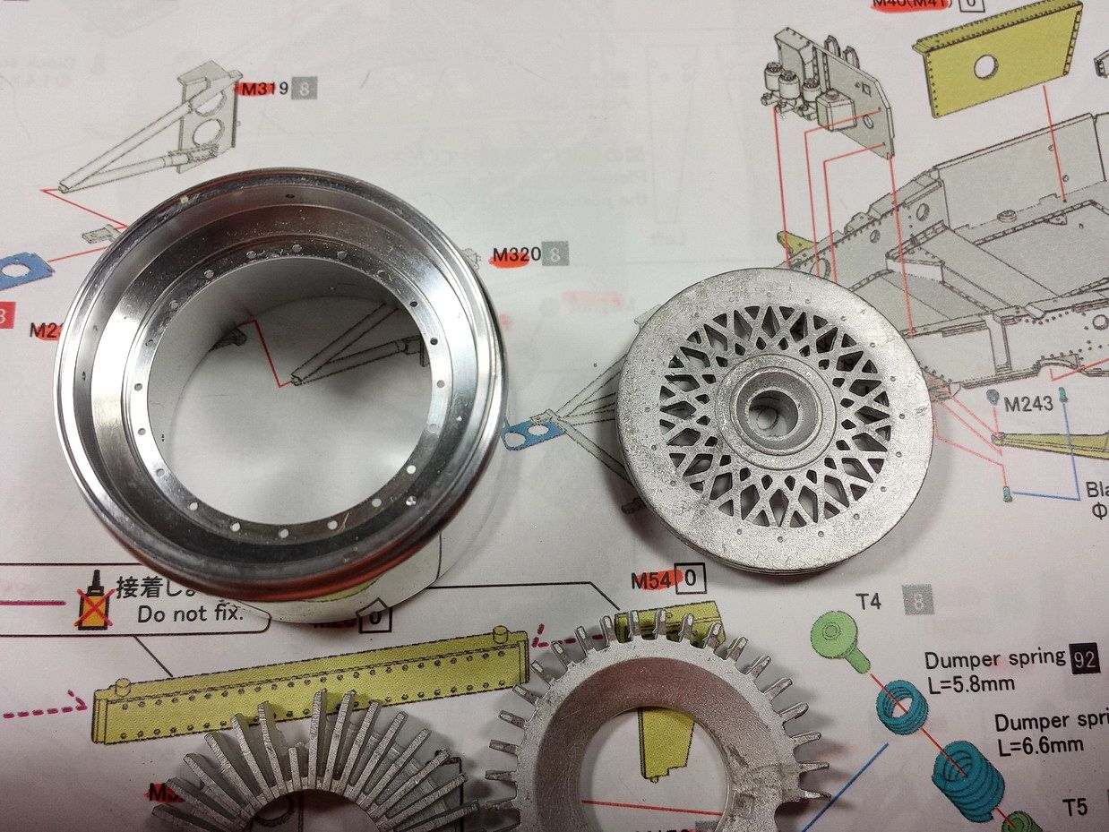

Once the parts were sorted and I started studying how to approach the build I decided to give in to my desire to build the wheels first. I just couldn't resist those wheels and tires...
The basic components of the wheels. Consists of the Machined rim, BBS Mesh insert, brake cooling fins (front wheels only) and the flat outer disc of the cooling fins.
http://i5.photobucket.com/albums/y197/justdande/MFH%2012th%20Scale%20Porsche%20956/20150510_104907_resize_zpsf1pjabt8.jpg (http://s5.photobucket.com/user/justdande/media/MFH%2012th%20Scale%20Porsche%20956/20150510_104907_resize_zpsf1pjabt8.jpg.html)
A closer view. The rims are pre-drilled for the torque screws that hold the mesh in. The mesh has divets where they need to be drilled. The shaft of the torque screws are larger than the holes in the rim so those in the rim must be re-drilled at a larger diameter.
http://i5.photobucket.com/albums/y197/justdande/MFH%2012th%20Scale%20Porsche%20956/20150510_105023_resize_zpst6js7yyr.jpg (http://s5.photobucket.com/user/justdande/media/MFH%2012th%20Scale%20Porsche%20956/20150510_105023_resize_zpst6js7yyr.jpg.html)
Also, the brake cooling fins are too thick. This bothered me from the moment I first opened the box.
http://i5.photobucket.com/albums/y197/justdande/MFH%2012th%20Scale%20Porsche%20956/20150510_104959_resize_zpsvjskpmzo.jpg (http://s5.photobucket.com/user/justdande/media/MFH%2012th%20Scale%20Porsche%20956/20150510_104959_resize_zpsvjskpmzo.jpg.html)
Some (a lot) of filing and sanding and I'm happier with the result. A minor detail, I guess, but I think it makes a difference.
http://i5.photobucket.com/albums/y197/justdande/MFH%2012th%20Scale%20Porsche%20956/20150510_123134_resize_zpsdlsjdaer.jpg (http://s5.photobucket.com/user/justdande/media/MFH%2012th%20Scale%20Porsche%20956/20150510_123134_resize_zpsdlsjdaer.jpg.html)

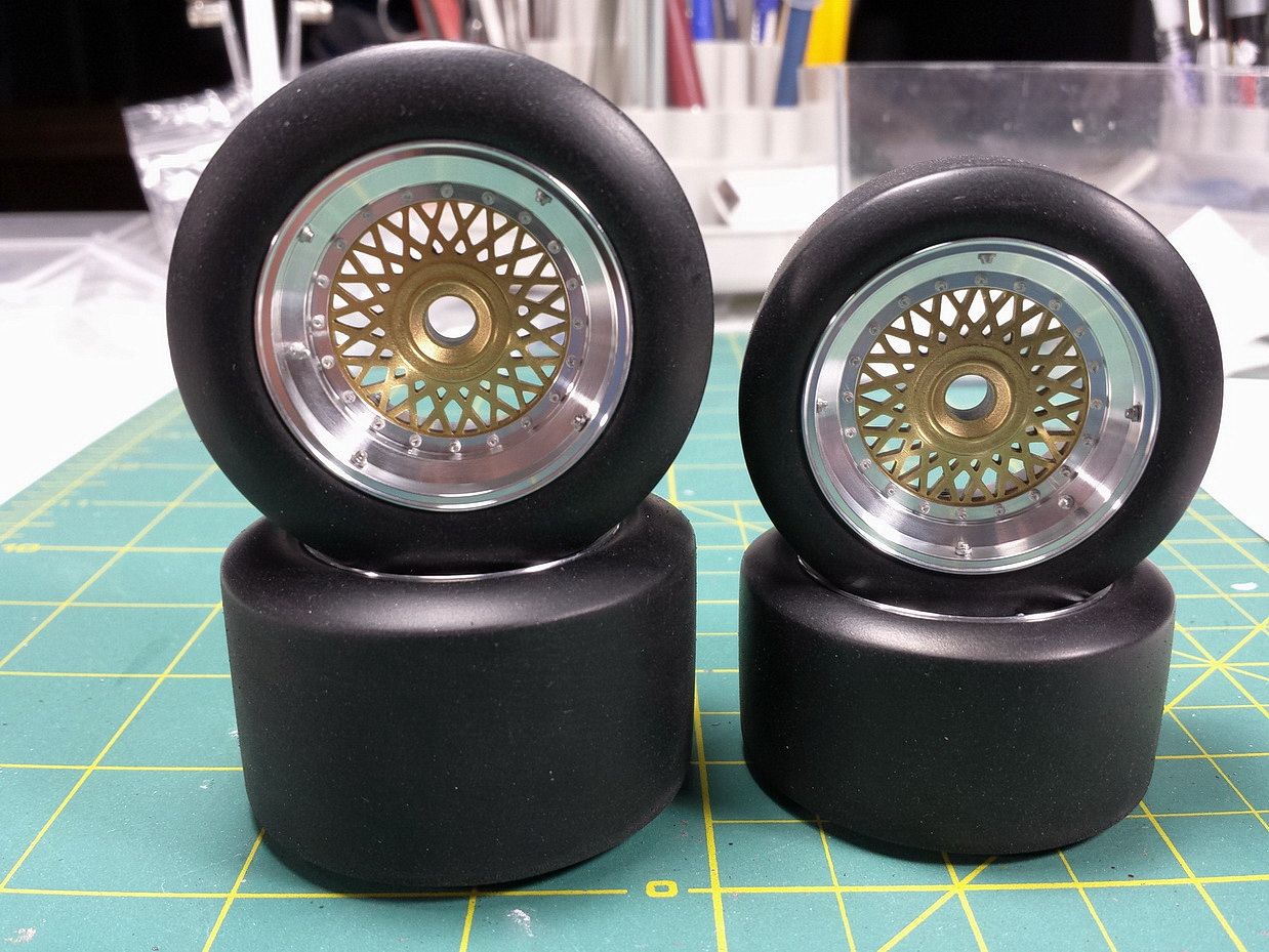

Several hours later and the basic wheels are drilled, painted and assembled. In this stage they are too bright and shiny. The still need to have the treads scuffed, decals added to the BBS wheels and also decals to the tires, a wheel balancing weight taped to the rim, a wash to tone things down a bit and dull coat over the decals before they're truly complete.
http://i5.photobucket.com/albums/y197/justdande/MFH%2012th%20Scale%20Porsche%20956/20150510_204549_resize_zpsiclvfs0u.jpg (http://s5.photobucket.com/user/justdande/media/MFH%2012th%20Scale%20Porsche%20956/20150510_204549_resize_zpsiclvfs0u.jpg.html)
http://i5.photobucket.com/albums/y197/justdande/MFH%2012th%20Scale%20Porsche%20956/20150510_204705_resize_zps9riqunv7.jpg (http://s5.photobucket.com/user/justdande/media/MFH%2012th%20Scale%20Porsche%20956/20150510_204705_resize_zps9riqunv7.jpg.html)
Well, that's a start. A long ways to go with this one. Update may be sporadic...
The kit is typical MFH resin and white metal, with lots of white metal parts, some turned aluminum parts, wires, screws, etc. There are some inaccuracies with this kit for this version of the car. Namely, the fuel system is incorrect and incomplete. The correct parts are 3D printed available through Shapeways. I have purchased those parts but still have some decisions to make which way I go. I actually like the looks of the incorrect fuel system better.
http://i5.photobucket.com/albums/y197/justdande/MFH%2012th%20Scale%20Porsche%20956/20150510_104916_resize_zpsnoxf6ier.jpg (http://s5.photobucket.com/user/justdande/media/MFH%2012th%20Scale%20Porsche%20956/20150510_104916_resize_zpsnoxf6ier.jpg.html)
http://i5.photobucket.com/albums/y197/justdande/MFH%2012th%20Scale%20Porsche%20956/20150510_104924_resize_zpsk98b9kba.jpg (http://s5.photobucket.com/user/justdande/media/MFH%2012th%20Scale%20Porsche%20956/20150510_104924_resize_zpsk98b9kba.jpg.html)

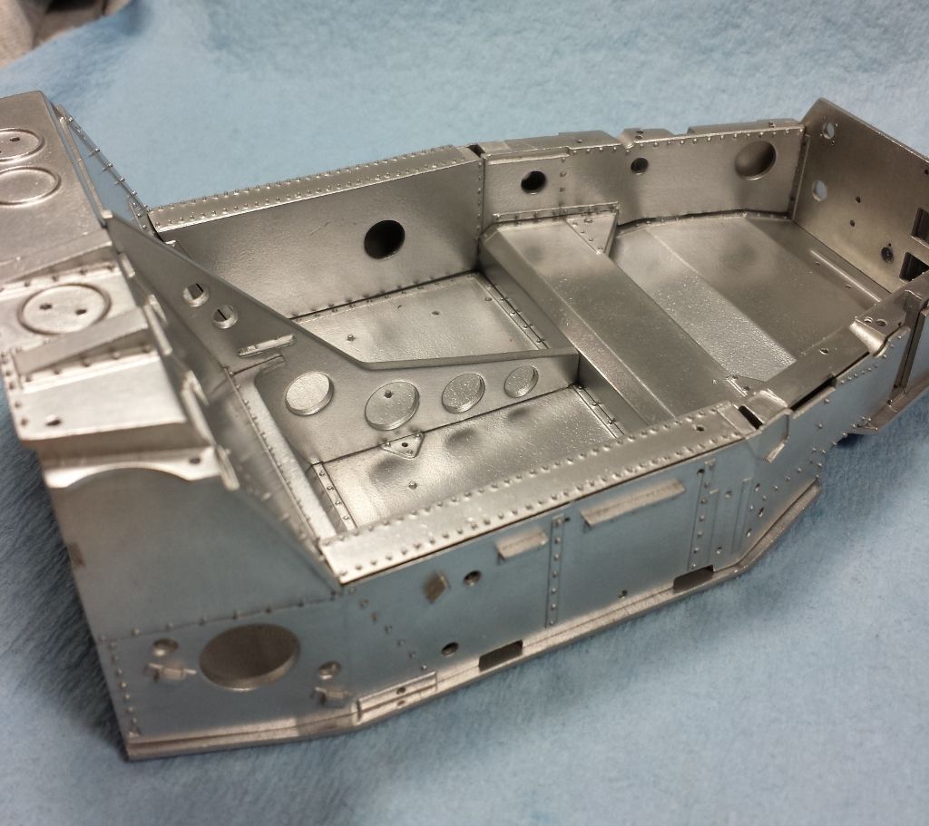

Just a small update...

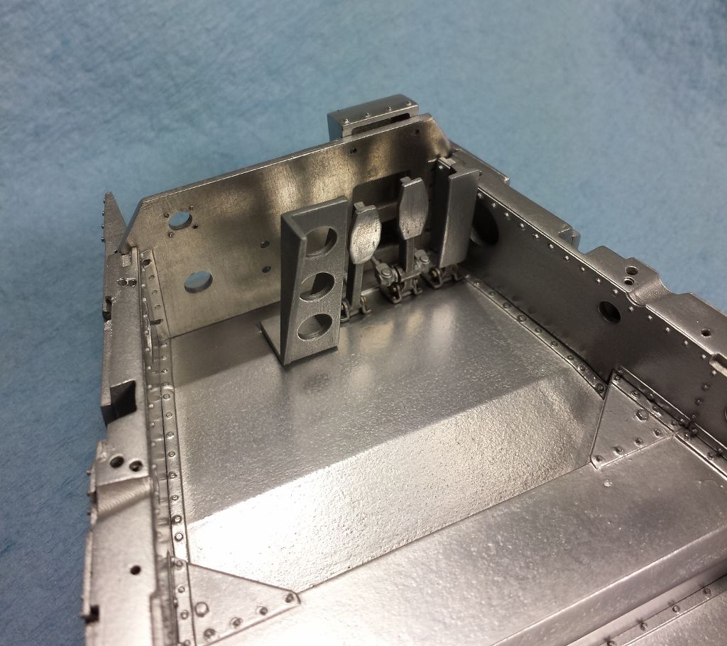

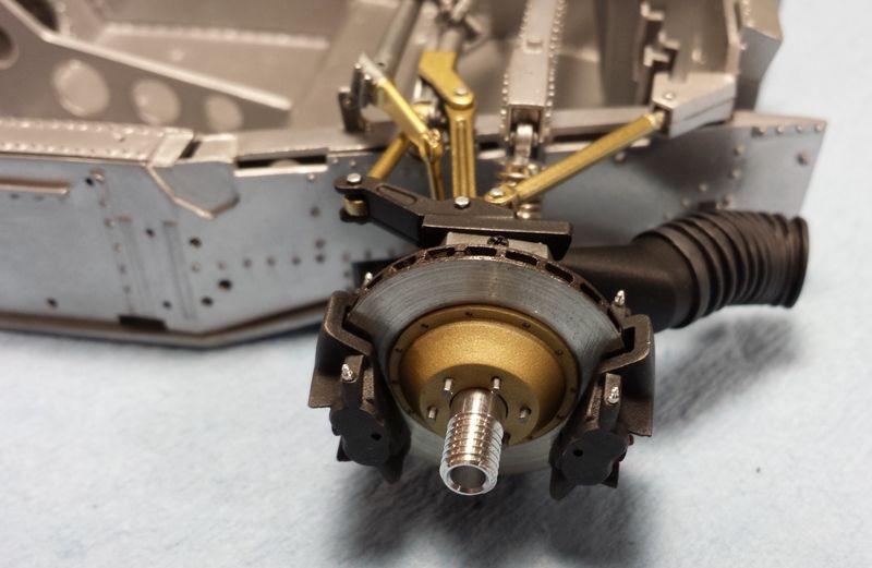

The kit's white metal parts that make up the chassis and monocoque has small divots that are supposed to represent rivets. I wanted to add rivets but after researching the small scale rivets that are available I decided to make my own. The reason I decided to make my own is 1) cost of after market rivets and by a rough count it's around 1300 rivets that would be needed, and 2) the ones I found that I could buy in (somewhat bulk) were stainless steel. I didn't want the expense and I didn't want to have to cut stainless steel rivets to length.
So, I "made" rivets using .4mm soldering wire.
First, I started by cutting the wire into small pieces at a length that made it easy to work with.
http://i5.photobucket.com/albums/y197/justdande/MFH%2012th%20Scale%20Porsche%20956/20150703_153858%201280x960%201024x768_zpsdxo2jzjc. jpg (http://s5.photobucket.com/user/justdande/media/MFH%2012th%20Scale%20Porsche%20956/20150703_153858%201280x960%201024x768_zpsdxo2jzjc. jpg.html)
http://i5.photobucket.com/albums/y197/justdande/MFH%2012th%20Scale%20Porsche%20956/20150703_161105%201280x960%201024x768_zpsr6ehpkab. jpg (http://s5.photobucket.com/user/justdande/media/MFH%2012th%20Scale%20Porsche%20956/20150703_161105%201280x960%201024x768_zpsr6ehpkab. jpg.html)
Next, I drilled all the molded divots a little deeper the allow the wire (rivet) to sit deeper into the part.
http://i5.photobucket.com/albums/y197/justdande/MFH%2012th%20Scale%20Porsche%20956/20150703_153826%201280x960%201024x768_zpsohhk5r3l. jpg (http://s5.photobucket.com/user/justdande/media/MFH%2012th%20Scale%20Porsche%20956/20150703_153826%201280x960%201024x768_zpsohhk5r3l. jpg.html)
Using needle point tweezers I picked up each cut piece of solder and dipped one end in superglue.
http://i5.photobucket.com/albums/y197/justdande/MFH%2012th%20Scale%20Porsche%20956/20150703_161122%201280x960%201024x768_zpsic4kuyx2. jpg (http://s5.photobucket.com/user/justdande/media/MFH%2012th%20Scale%20Porsche%20956/20150703_161122%201280x960%201024x768_zpsic4kuyx2. jpg.html)
I placed each rivet (piece of solder) in the hole and allowed to dry.
http://i5.photobucket.com/albums/y197/justdande/MFH%2012th%20Scale%20Porsche%20956/20150703_161139%201280x960%201024x768_zpsbgwalv2n. jpg (http://s5.photobucket.com/user/justdande/media/MFH%2012th%20Scale%20Porsche%20956/20150703_161139%201280x960%201024x768_zpsbgwalv2n. jpg.html)
http://i5.photobucket.com/albums/y197/justdande/MFH%2012th%20Scale%20Porsche%20956/20150704_083528%201280x960%201024x768_zpsv5wn0ams. jpg (http://s5.photobucket.com/user/justdande/media/MFH%2012th%20Scale%20Porsche%20956/20150704_083528%201280x960%201024x768_zpsv5wn0ams. jpg.html)
Once dry and set in place I used and sanding stick and sanded them all down to an even and consistent level.
http://i5.photobucket.com/albums/y197/justdande/MFH%2012th%20Scale%20Porsche%20956/20150703_203717%201280x960%201024x768_zps11elti7s. jpg (http://s5.photobucket.com/user/justdande/media/MFH%2012th%20Scale%20Porsche%20956/20150703_203717%201280x960%201024x768_zps11elti7s. jpg.html)
http://i5.photobucket.com/albums/y197/justdande/MFH%2012th%20Scale%20Porsche%20956/20150703_165005%201280x960%201024x768_zpsxkrlv8jn. jpg (http://s5.photobucket.com/user/justdande/media/MFH%2012th%20Scale%20Porsche%20956/20150703_165005%201280x960%201024x768_zpsxkrlv8jn. jpg.html)
And the final result after primer...
http://i5.photobucket.com/albums/y197/justdande/MFH%2012th%20Scale%20Porsche%20956/20150703_203303%201280x960%201024x768_zpsr5wmcbgc. jpg (http://s5.photobucket.com/user/justdande/media/MFH%2012th%20Scale%20Porsche%20956/20150703_203303%201280x960%201024x768_zpsr5wmcbgc. jpg.html)
http://i5.photobucket.com/albums/y197/justdande/MFH%2012th%20Scale%20Porsche%20956/20150703_203312%201280x960%201024x768_zpsqdialwwi. jpg (http://s5.photobucket.com/user/justdande/media/MFH%2012th%20Scale%20Porsche%20956/20150703_203312%201280x960%201024x768_zpsqdialwwi. jpg.html)
May not be perfect but it represents a rivet more than not having them at all and the soft solder is really easy to cut and work with.

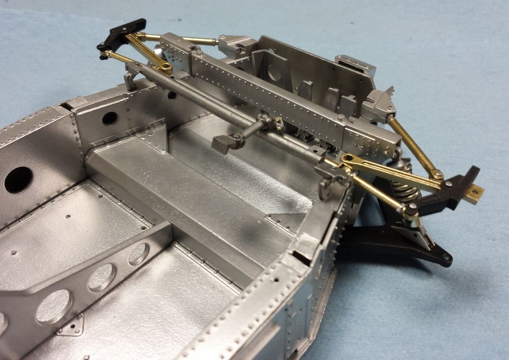

Thanks guys. Not much more to show for now but more rivets have been added. In fact, I'm finally done with that step. Here's the last part...
http://i5.photobucket.com/albums/y197/justdande/MFH%2012th%20Scale%20Porsche%20956/20150708_110422_resized_1%201024x768_zps3p2ray9t.j pg (http://s5.photobucket.com/user/justdande/media/MFH%2012th%20Scale%20Porsche%20956/20150708_110422_resized_1%201024x768_zps3p2ray9t.j pg.html)
http://i5.photobucket.com/albums/y197/justdande/MFH%2012th%20Scale%20Porsche%20956/20150708_110439_resized_1%201024x768_zpsaggk02cr.j pg (http://s5.photobucket.com/user/justdande/media/MFH%2012th%20Scale%20Porsche%20956/20150708_110439_resized_1%201024x768_zpsaggk02cr.j pg.html)

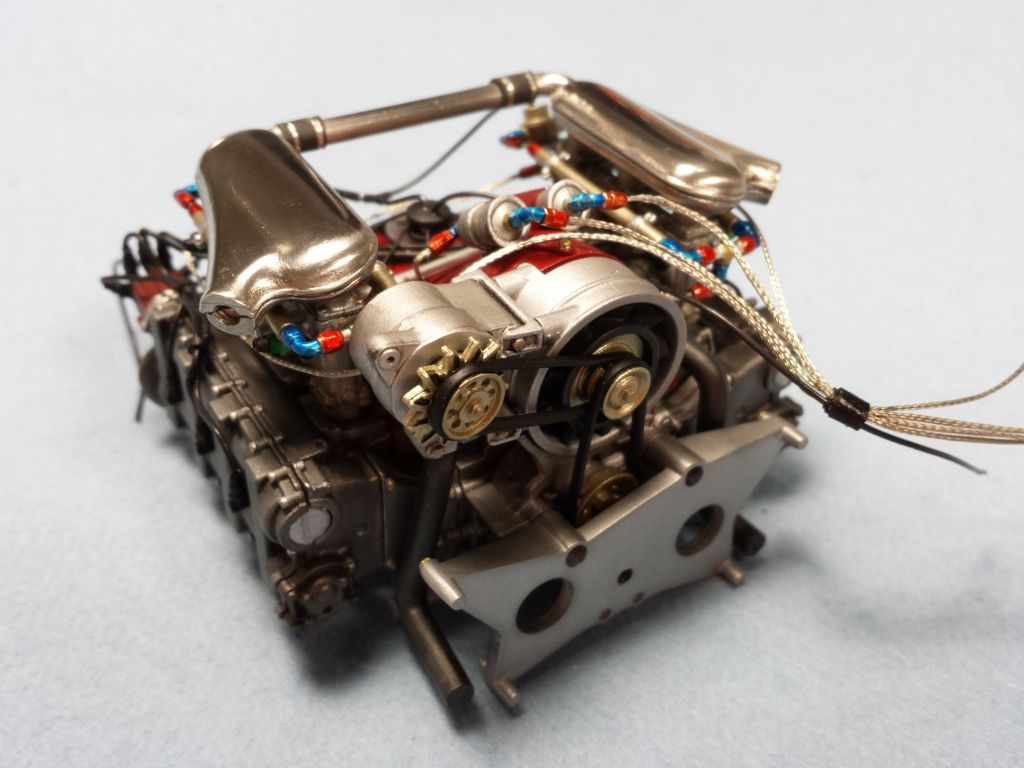

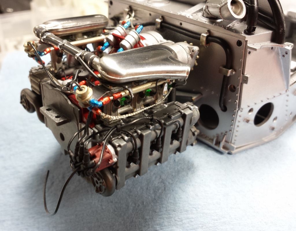

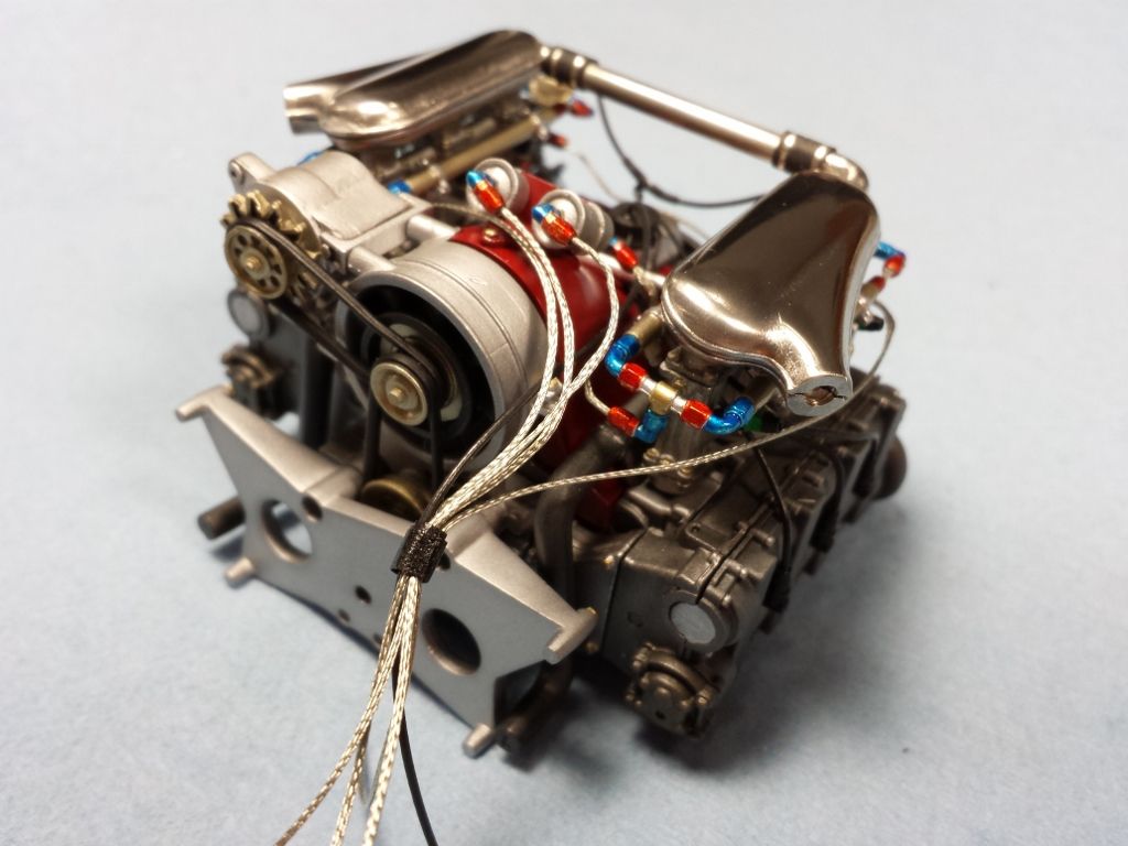

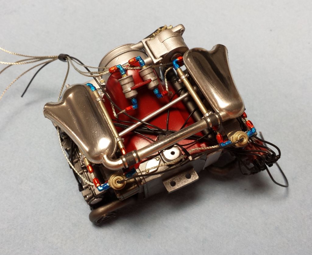

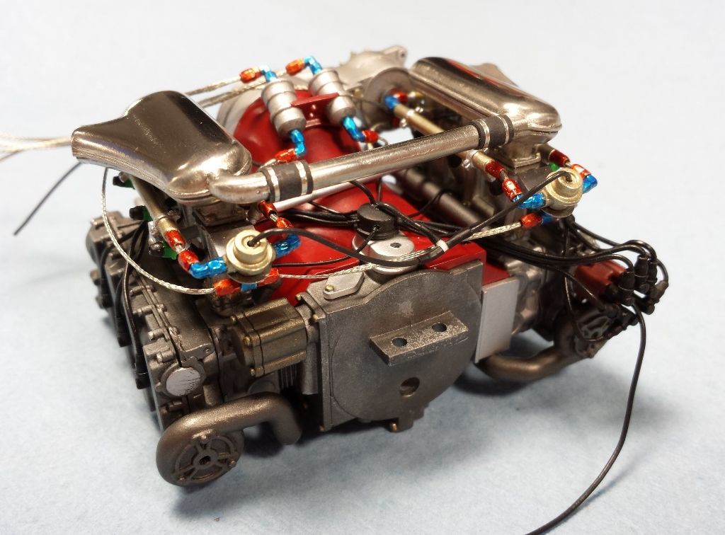

Finally, engine assembly begins...
The parts were primed with grey primer then painted with various metalizers. Although difficult to tell in these photos the block was painted gun metal, the cylinders were painted with aluminum and the heads were painted with steel.
All parts were then overcaoted with flat clear to seal the metalizer. Once the flat clear had dried all the parts were washed with a medium/dark wash to bring out some details. After the wash dried a dry brush using AK Interactive Metal Wax (various shades of metal) to highlight some areas and bring it back to a 'metal' look.
It will get another light dull/semi-gloss clear coat because I think it's a little too "sparkly" at the moment. Last the nuts, bolts and other detail will be picked out and detail painted.

Thanks everyone for the encouragement. Here's a few more engine pics after a little more progress.
Bottom of engine (never to be seen once installed in the car)
http://i5.photobucket.com/albums/y197/justdande/MFH%2012th%20Scale%20Porsche%20956/20150716_215935_zpsc1n06sqd.jpg (http://s5.photobucket.com/user/justdande/media/MFH%2012th%20Scale%20Porsche%20956/20150716_215935_zpsc1n06sqd.jpg.html)
Top of engine. Still a lot more parts to add, details to paint, then all the plumbing and wiring and there'll need to be touch-up at the end. I hope to have the engine finished up this weekend.
http://i5.photobucket.com/albums/y197/justdande/MFH%2012th%20Scale%20Porsche%20956/20150716_220317_zpscj6ak54x.jpg (http://s5.photobucket.com/user/justdande/media/MFH%2012th%20Scale%20Porsche%20956/20150716_220317_zpscj6ak54x.jpg.html)
http://i5.photobucket.com/albums/y197/justdande/MFH%2012th%20Scale%20Porsche%20956/20150716_220336_zpslmvrsoua.jpg (http://s5.photobucket.com/user/justdande/media/MFH%2012th%20Scale%20Porsche%20956/20150716_220336_zpslmvrsoua.jpg.html)

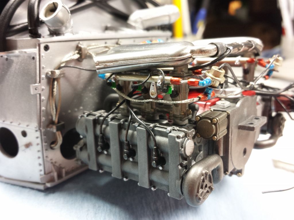

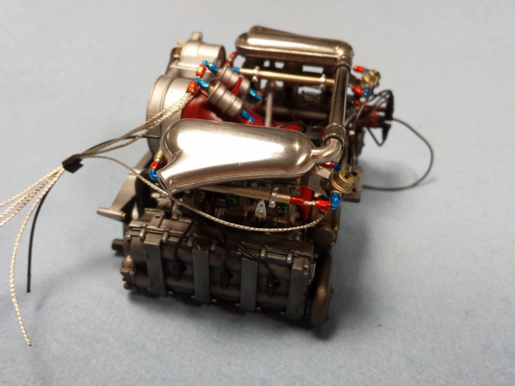

More engine progress. Some plumbing added, etc. The intake plenum on top of the engine is one of the few parts that will stay natural metal, I think it polishes up very close to how the real car looks.
I don't really like the "anodized" fittings. Basically just molded white metal fittings painted silver then painted with Tamiya clear red and clear blue. To me the color is not consistent enough and they're too glossy. I can take care of the glossiness by brushing a light coat of flat clear over them, which I plan to do before I go any further.
Here's a few general pics. The plenum is just set in place, not glued. I still have more work to do with wiring and plumbing before it gets attached permanently. If the front of the engine were more visible in the finished build the molded in belts on the pulleys would need to be removed and replaced with tape or some other material.
http://i5.photobucket.com/albums/y197/justdande/MFH%2012th%20Scale%20Porsche%20956/20150719_191055%201024x768_zpsiu0inpjj.jpg (http://s5.photobucket.com/user/justdande/media/MFH%2012th%20Scale%20Porsche%20956/20150719_191055%201024x768_zpsiu0inpjj.jpg.html)
http://i5.photobucket.com/albums/y197/justdande/MFH%2012th%20Scale%20Porsche%20956/20150719_191117%201024x786_zpsfvkydwbj.jpg (http://s5.photobucket.com/user/justdande/media/MFH%2012th%20Scale%20Porsche%20956/20150719_191117%201024x786_zpsfvkydwbj.jpg.html)
http://i5.photobucket.com/albums/y197/justdande/MFH%2012th%20Scale%20Porsche%20956/20150719_191233%201024x749_zpst72psvqx.jpg (http://s5.photobucket.com/user/justdande/media/MFH%2012th%20Scale%20Porsche%20956/20150719_191233%201024x749_zpst72psvqx.jpg.html)
http://i5.photobucket.com/albums/y197/justdande/MFH%2012th%20Scale%20Porsche%20956/20150719_191311%201024x768_zps6ipyfnsf.jpg (http://s5.photobucket.com/user/justdande/media/MFH%2012th%20Scale%20Porsche%20956/20150719_191311%201024x768_zps6ipyfnsf.jpg.html)
http://i5.photobucket.com/albums/y197/justdande/MFH%2012th%20Scale%20Porsche%20956/20150719_191335%201024x768_zpsyjjan6gz.jpg (http://s5.photobucket.com/user/justdande/media/MFH%2012th%20Scale%20Porsche%20956/20150719_191335%201024x768_zpsyjjan6gz.jpg.html)

Hemi Killer
07-21-2015, 03:37 AM
I like the colors of the metal, looks awesome.
Vric
07-21-2015, 04:44 PM
Impressive!
heyes57
07-22-2015, 02:00 PM
Great work on the Porsche Eric. With the Red/Blue A/N fittings, try the ones from this guy in America, he's quite brilliant and has just introduced anodised range. Keep up the excellent work, following with great interest.

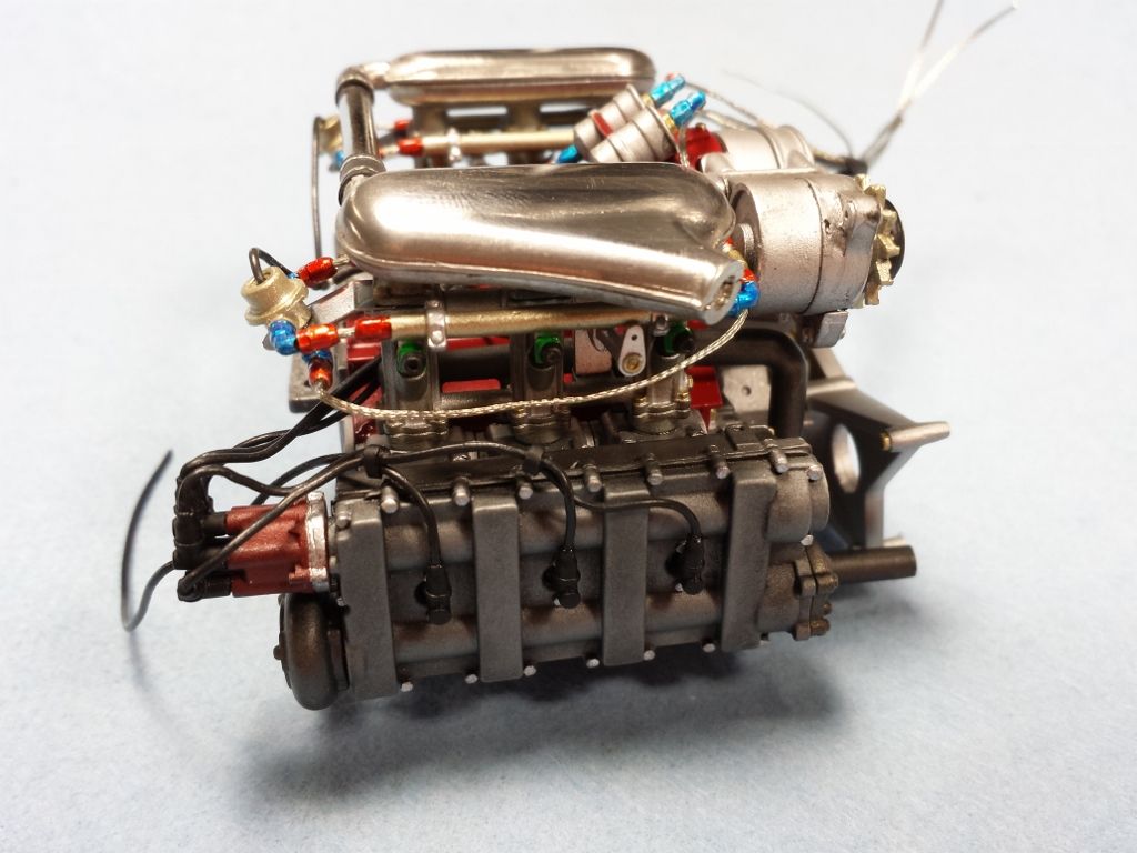

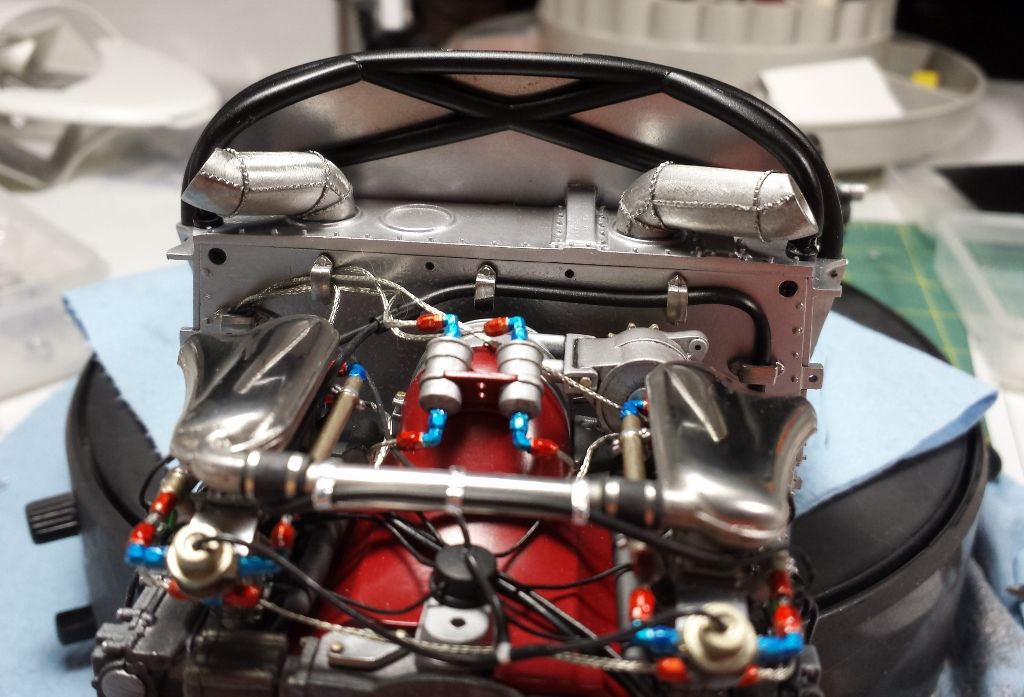

The engine is now complete. Added more fuel lines, vacuum lines from the fuel pressure regulators (at least I think that's what they are), and from each intake. The vacuum lines converge at the black cap on top of the engine. As it get's installed to the chassis there will likely be more cable ties and minor details, touch ups, etc., added.
Thanks for looking...
http://i5.photobucket.com/albums/y197/justdande/MFH%2012th%20Scale%20Porsche%20956/20150725_163843%201024x756_zpsjotzdut0.jpg (http://s5.photobucket.com/user/justdande/media/MFH%2012th%20Scale%20Porsche%20956/20150725_163843%201024x756_zpsjotzdut0.jpg.html)
http://i5.photobucket.com/albums/y197/justdande/MFH%2012th%20Scale%20Porsche%20956/20150725_163948%201024x837_zpskkqoswqk.jpg (http://s5.photobucket.com/user/justdande/media/MFH%2012th%20Scale%20Porsche%20956/20150725_163948%201024x837_zpskkqoswqk.jpg.html)
http://i5.photobucket.com/albums/y197/justdande/MFH%2012th%20Scale%20Porsche%20956/20150725_163939%201024x768_zpsfbo9xkyv.jpg (http://s5.photobucket.com/user/justdande/media/MFH%2012th%20Scale%20Porsche%20956/20150725_163939%201024x768_zpsfbo9xkyv.jpg.html)
http://i5.photobucket.com/albums/y197/justdande/MFH%2012th%20Scale%20Porsche%20956/20150725_163857%201024x768_zpsfr8epb2t.jpg (http://s5.photobucket.com/user/justdande/media/MFH%2012th%20Scale%20Porsche%20956/20150725_163857%201024x768_zpsfr8epb2t.jpg.html)
http://i5.photobucket.com/albums/y197/justdande/MFH%2012th%20Scale%20Porsche%20956/20150725_163927%201024x768_zpsiwocjezy.jpg (http://s5.photobucket.com/user/justdande/media/MFH%2012th%20Scale%20Porsche%20956/20150725_163927%201024x768_zpsiwocjezy.jpg.html)
http://i5.photobucket.com/albums/y197/justdande/MFH%2012th%20Scale%20Porsche%20956/20150725_163915%201024x768_zpsc9yvx9so.jpg (http://s5.photobucket.com/user/justdande/media/MFH%2012th%20Scale%20Porsche%20956/20150725_163915%201024x768_zpsc9yvx9so.jpg.html)

Another quick update.
(I realized after my last post that the engine is not quite complete. I still need to add the wires to the individual green fuel injectors.)

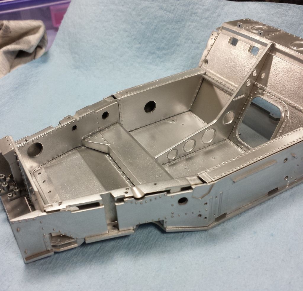

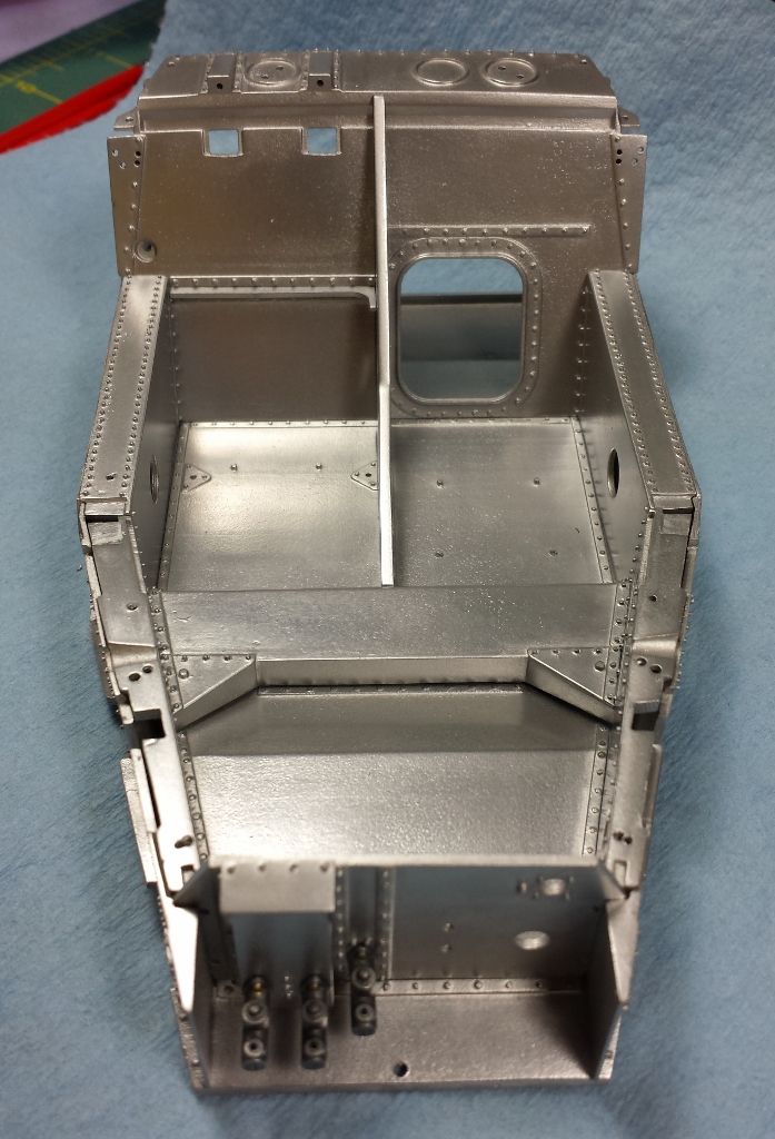

I've made some progress on the chassis. Having previously added all the rivets and primed all the parts I moved ahead and sprayed all the parts with flat aluminum then using various brushes and cloth I polished all the parts with Rub-N-Buff Silver Leaf paste and polished to a shine. Overall I'm happy with the results but unhappy with the fact that the reflectivity really shows the pitting and ruff finish of the white metal parts. (The photos make it look worse). Thankfully a lot of this in not as visible on the completed model.
The chassis partly assembled.
http://i5.photobucket.com/albums/y197/justdande/MFH%2012th%20Scale%20Porsche%20956/20150726_145859%20697x1024_zpsmanzxjaf.jpg (http://s5.photobucket.com/user/justdande/media/MFH%2012th%20Scale%20Porsche%20956/20150726_145859%20697x1024_zpsmanzxjaf.jpg.html)
http://i5.photobucket.com/albums/y197/justdande/MFH%2012th%20Scale%20Porsche%20956/20150726_145918%201024x911_zpsifbo4rey.jpg (http://s5.photobucket.com/user/justdande/media/MFH%2012th%20Scale%20Porsche%20956/20150726_145918%201024x911_zpsifbo4rey.jpg.html)
http://i5.photobucket.com/albums/y197/justdande/MFH%2012th%20Scale%20Porsche%20956/20150726_145934%201024x982_zpsqtnqsadq.jpg (http://s5.photobucket.com/user/justdande/media/MFH%2012th%20Scale%20Porsche%20956/20150726_145934%201024x982_zpsqtnqsadq.jpg.html)

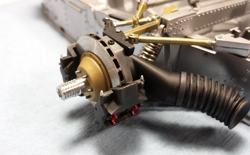

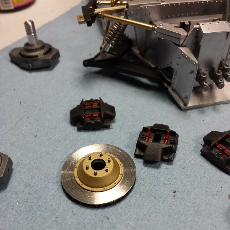

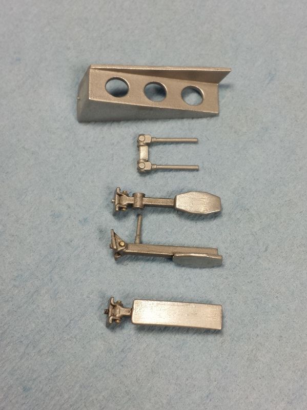

Foot pedals added.
http://i5.photobucket.com/albums/y197/justdande/MFH%2012th%20Scale%20Porsche%20956/20150726_145758%20599x800_zps7veq3jwf.jpg (http://s5.photobucket.com/user/justdande/media/MFH%2012th%20Scale%20Porsche%20956/20150726_145758%20599x800_zps7veq3jwf.jpg.html)
http://i5.photobucket.com/albums/y197/justdande/MFH%2012th%20Scale%20Porsche%20956/20150726_150846%201024x911_zpsmdgqgegn.jpg (http://s5.photobucket.com/user/justdande/media/MFH%2012th%20Scale%20Porsche%20956/20150726_150846%201024x911_zpsmdgqgegn.jpg.html)

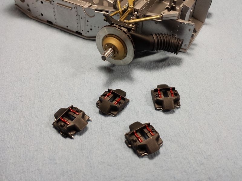

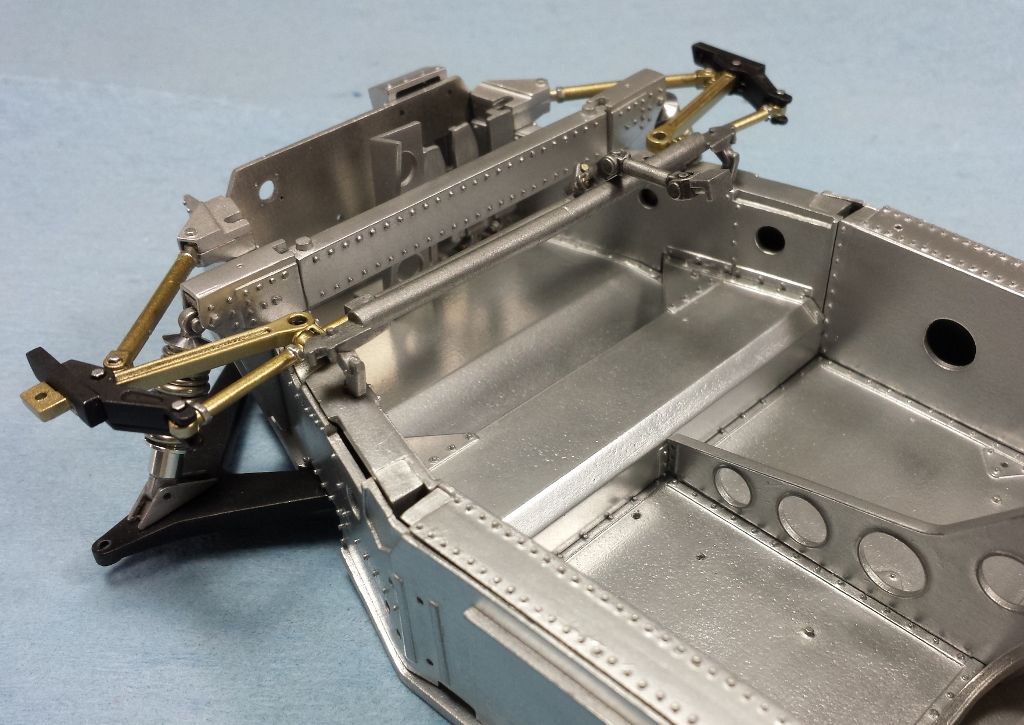

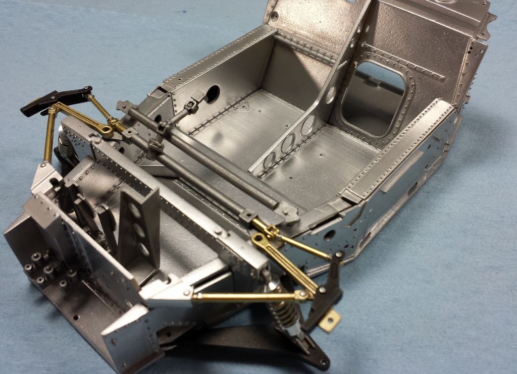

Front suspension and steering rack added.
http://i5.photobucket.com/albums/y197/justdande/MFH%2012th%20Scale%20Porsche%20956/20150726_194601%201%201024x741_zpsgvxjnte7.jpg (http://s5.photobucket.com/user/justdande/media/MFH%2012th%20Scale%20Porsche%20956/20150726_194601%201%201024x741_zpsgvxjnte7.jpg.htm l)
http://i5.photobucket.com/albums/y197/justdande/MFH%2012th%20Scale%20Porsche%20956/20150726_194613%201024x725_zpsag4xurzx.jpg (http://s5.photobucket.com/user/justdande/media/MFH%2012th%20Scale%20Porsche%20956/20150726_194613%201024x725_zpsag4xurzx.jpg.html)
http://i5.photobucket.com/albums/y197/justdande/MFH%2012th%20Scale%20Porsche%20956/20150726_194630%201024x724_zpse22tc1u1.jpg (http://s5.photobucket.com/user/justdande/media/MFH%2012th%20Scale%20Porsche%20956/20150726_194630%201024x724_zpse22tc1u1.jpg.html)
Foot pedals added.
ianc911
07-28-2015, 02:01 PM
Really looking good; that engine is a gem!
ianc
ianc
John18d
07-29-2015, 07:19 PM
Wow Eric - you really must have patience to do all that rivet work.
It does look good though better than from MFH cast in rivets.
It is a shame about the pitting of the aluminum sheets.
could that be filled and made flat before painting? just asking.
Front suspension is coming together nicely.
Are the gold colored suspension bits painted or is that the MFH color?
Doing excellent Eric - I'll keep watching with anticipation.
Cheers
John
Cheers
John
Eric Cole
07-30-2015, 08:33 AM
Thanks guys.
John, they varied in color on the real cars. In my research I've seen black, silver and gold or combinations of those colors. However, the majority seemed to be gold. Gold is also the color called out by MFH. I chose gold based on my research. I have used very few colors called out by MFH. Shades of those colors maybe but very few actual colors they call for.

I think those rivets worked out quite well. They looked a little off at first, but after the paint I think they look great. Much better than leaving it the way it was.

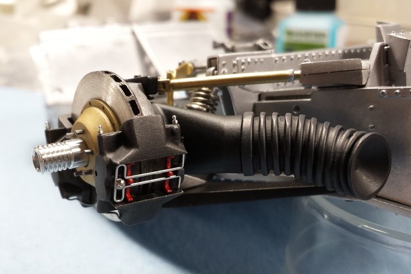

I was able to get some work done on the front brakes over the weekend.

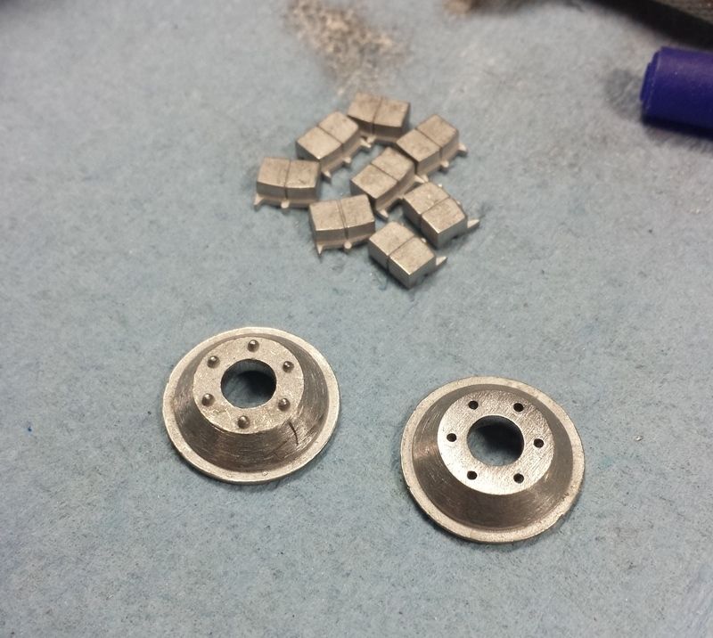

First thing I did was remove the molded in wheel locator studs and drill holes for new studs to be added. Those are the brake pads in the background.
http://i5.photobucket.com/albums/y197/justdande/MFH%2012th%20Scale%20Porsche%20956/20150731_165238_zpshej2qsx5.jpg (http://s5.photobucket.com/user/justdande/media/MFH%2012th%20Scale%20Porsche%20956/20150731_165238_zpshej2qsx5.jpg.html)
Then added the new studs, sanded the rotors to give a worn look. There were a few gouges in the rotors I couldn't remove without significant grinding but for the most part the sanding marks indicate the direction of travel on the rotors. I also assembled the rotor and painted the edge a darker metallic color. The calipers were painted flat black then dry brushed with dark grey metalizer and the brake pads were painted and added.
http://i5.photobucket.com/albums/y197/justdande/MFH%2012th%20Scale%20Porsche%20956/20150801_123232_zps6ijulta4.jpg (http://s5.photobucket.com/user/justdande/media/MFH%2012th%20Scale%20Porsche%20956/20150801_123232_zps6ijulta4.jpg.html)
The spindle was mounted to the suspension and the rotor and calipers were mounted to the spindle.
http://i5.photobucket.com/albums/y197/justdande/MFH%2012th%20Scale%20Porsche%20956/20150801_143029_zps1s1ewhj3.jpg (http://s5.photobucket.com/user/justdande/media/MFH%2012th%20Scale%20Porsche%20956/20150801_143029_zps1s1ewhj3.jpg.html)
http://i5.photobucket.com/albums/y197/justdande/MFH%2012th%20Scale%20Porsche%20956/20150801_144445_zpsl88ro3b2.jpg (http://s5.photobucket.com/user/justdande/media/MFH%2012th%20Scale%20Porsche%20956/20150801_144445_zpsl88ro3b2.jpg.html)
http://i5.photobucket.com/albums/y197/justdande/MFH%2012th%20Scale%20Porsche%20956/20150801_144503_zpszkkuudow.jpg (http://s5.photobucket.com/user/justdande/media/MFH%2012th%20Scale%20Porsche%20956/20150801_144503_zpszkkuudow.jpg.html)
All the other hardware added. The brake pad clip and screw to hold it in place, the bleeder valves and brake line connections, etc. Bleeder valves are from RBMotion.
http://i5.photobucket.com/albums/y197/justdande/MFH%2012th%20Scale%20Porsche%20956/20150801_151043_zpsr15thfol.jpg (http://s5.photobucket.com/user/justdande/media/MFH%2012th%20Scale%20Porsche%20956/20150801_151043_zpsr15thfol.jpg.html)
I still need to get everything plumbed and wired.

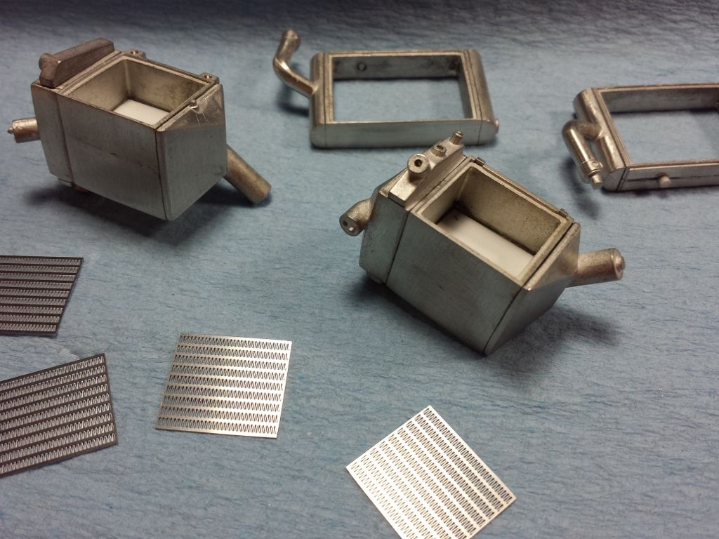

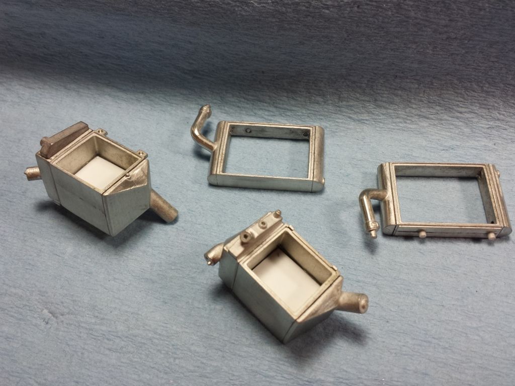

Started working on the radiators. They are hollow and when the photoetched radiator faces are added you can see all the way through. I didn't like this so I added sheet plastic inside (two are done, the others still need to be done) and will paint the inside black before adding the faces.
http://i5.photobucket.com/albums/y197/justdande/MFH%2012th%20Scale%20Porsche%20956/20150823_152626%201024x768_zps5fhymmm5.jpg (http://s5.photobucket.com/user/justdande/media/MFH%2012th%20Scale%20Porsche%20956/20150823_152626%201024x768_zps5fhymmm5.jpg.html)
http://i5.photobucket.com/albums/y197/justdande/MFH%2012th%20Scale%20Porsche%20956/20150823_152649%201024x768_zpsyjdrhy5f.jpg (http://s5.photobucket.com/user/justdande/media/MFH%2012th%20Scale%20Porsche%20956/20150823_152649%201024x768_zpsyjdrhy5f.jpg.html)

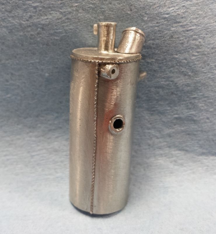

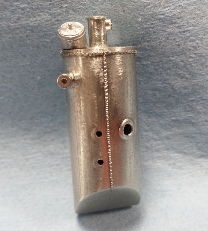

Started working on the tank which goes together in two halves. Looking at the real car it appears to be two halves with a lid all welded together. After assembly I added 'weld' lines by gluing thin solder wire over the seams where the kit parts glue together. Once set I used the knurled surface of my pin-vise and rolled it over the solder allowing the pattern of the knurled surface to press into the soft solder. Once primed, painted with metalizer and polished out/weathered a little it should look decent. I did the same thing for the fuel filler tubes as well.
http://i5.photobucket.com/albums/y197/justdande/MFH%2012th%20Scale%20Porsche%20956/20150823_113134%20723x800_zpsttfxs1gp.jpg (http://s5.photobucket.com/user/justdande/media/MFH%2012th%20Scale%20Porsche%20956/20150823_113134%20723x800_zpsttfxs1gp.jpg.html)
http://i5.photobucket.com/albums/y197/justdande/MFH%2012th%20Scale%20Porsche%20956/20150823_113123%20740x800_zpsjhpmluld.jpg (http://s5.photobucket.com/user/justdande/media/MFH%2012th%20Scale%20Porsche%20956/20150823_113123%20740x800_zpsjhpmluld.jpg.html)
I also mated the engine to the monocoque. Added the fuel injector wiring harnesses, additional plumbing and over-coated all the anodized fittings with flat clear paint to tone them down a little. I still need to add the throttle linkage on one side and throttle position sensor on the other along with the associated wiring. You can also see the fuel filler tubes in place. I don't know if the weld seams on the filler tubes are accurate for this car or not. Random pics of real cars had them sometimes and had smooth tubes at other times. I liked the look and think the effect will be nice on the finished model.
http://i5.photobucket.com/albums/y197/justdande/MFH%2012th%20Scale%20Porsche%20956/20150823_093103%201024x768_zpsckqwjcl6.jpg (http://s5.photobucket.com/user/justdande/media/MFH%2012th%20Scale%20Porsche%20956/20150823_093103%201024x768_zpsckqwjcl6.jpg.html)
http://i5.photobucket.com/albums/y197/justdande/MFH%2012th%20Scale%20Porsche%20956/20150823_123519%201024x697_zps5izsj4y1.jpg (http://s5.photobucket.com/user/justdande/media/MFH%2012th%20Scale%20Porsche%20956/20150823_123519%201024x697_zps5izsj4y1.jpg.html)
http://i5.photobucket.com/albums/y197/justdande/MFH%2012th%20Scale%20Porsche%20956/20150823_192340%201024x768_zpstjtdzatm.jpg (http://s5.photobucket.com/user/justdande/media/MFH%2012th%20Scale%20Porsche%20956/20150823_192340%201024x768_zpstjtdzatm.jpg.html)
http://i5.photobucket.com/albums/y197/justdande/MFH%2012th%20Scale%20Porsche%20956/20150823_192224%201024x801_zpsupjhljls.jpg (http://s5.photobucket.com/user/justdande/media/MFH%2012th%20Scale%20Porsche%20956/20150823_192224%201024x801_zpsupjhljls.jpg.html)
Front bulkhead, support bars, tow hook and brake/Windshield washer fluid reservoirs added. The reservoirs still need to be plumbed and wired.
http://i5.photobucket.com/albums/y197/justdande/MFH%2012th%20Scale%20Porsche%20956/20150823_192913%201024x719_zpsulwmcmdp.jpg (http://s5.photobucket.com/user/justdande/media/MFH%2012th%20Scale%20Porsche%20956/20150823_192913%201024x719_zpsulwmcmdp.jpg.html)

Great idea for the weld seams. Loving the detail work.

Great solution on the weld lines. Really a gem so far,

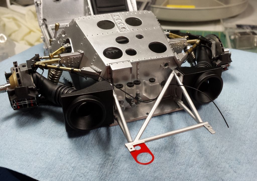

A few minor updates from this weekend's modeling sessions.
I started off by adding the rear support rods and oil tank as well as the shifter linkage. The shifter linkage still needs some detail painting.
http://i5.photobucket.com/albums/y197/justdande/MFH%2012th%20Scale%20Porsche%20956/20150830_103048%202%201024x768_zpspanvpo3k.jpg (http://s5.photobucket.com/user/justdande/media/MFH%2012th%20Scale%20Porsche%20956/20150830_103048%202%201024x768_zpspanvpo3k.jpg.htm l)
http://i5.photobucket.com/albums/y197/justdande/MFH%2012th%20Scale%20Porsche%20956/20150830_103103%202%201024x768_zpsis0jxd4k.jpg (http://s5.photobucket.com/user/justdande/media/MFH%2012th%20Scale%20Porsche%20956/20150830_103103%202%201024x768_zpsis0jxd4k.jpg.htm l)
With the weight of the engine constantly pulling against the firewall I could feel the engine beginning to loosen the more I handled and worked with the model. I thought that it would tighten up when I added the support rods but there really is only small surface areas to glue the support rods.
Attaching the first half of the trans-axle was also a tight fit. I was constantly knocking things loose while trying to make it work and the more I handled it the more loose the engine mounting became. Personally, I feel there's too much engine weight for how the kit is designed but I know others have built the kit so it must just be me screwing up! :screwy:
Anyway... I was able to get things sorted out but I knew I would always be concerned about the weight and the constant stress created by the weight of the engine so I "pinned" all of the attachment points. I drilled a very small diameter hole at all the locations depicted by arrows. The holes were drilled in the direction of the arrow as well. After drilling the holes I inserted a very fine piece of metal guitar string in the hole, cut to length.
On the top section of the support there is a molded in hex-head bolt so I drilled through the middle of that and through the roll bar support and inserted the wire through the hole with CA glue. The bottom hole was drilled through the bracket and support rod and then the wire inserted and glued in place. At the back end where the rod mounts to the transaxle I drilled from the bottom through the transaxle and through the support rod and inserted the wire from the bottom with CA glue.
I repeated this process with the support rods on both sides of the car. The result is a very strong support system and a lot less stress on the engine (and a lot less stress on me personally) :mad:

The exhaust and turbos were also added. The wastegate/blowoff valves still need to be plumbed as well. I got as far as drilling the holes for it.
http://i5.photobucket.com/albums/y197/justdande/MFH%2012th%20Scale%20Porsche%20956/20150907_162709_zps23n4pypn.jpg (http://s5.photobucket.com/user/justdande/media/MFH%2012th%20Scale%20Porsche%20956/20150907_162709_zps23n4pypn.jpg.html)
http://i5.photobucket.com/albums/y197/justdande/MFH%2012th%20Scale%20Porsche%20956/20150907_153354_zpsm00plqg2.jpg (http://s5.photobucket.com/user/justdande/media/MFH%2012th%20Scale%20Porsche%20956/20150907_153354_zpsm00plqg2.jpg.html)
http://i5.photobucket.com/albums/y197/justdande/MFH%2012th%20Scale%20Porsche%20956/20150906_145510_zpsznm9tiyc.jpg (http://s5.photobucket.com/user/justdande/media/MFH%2012th%20Scale%20Porsche%20956/20150906_145510_zpsznm9tiyc.jpg.html)

Thanks guys, here's another small update to the transaxle, rear suspension and wheels/tires.
Transaxle/suspension. Really no issues assembling this section. The brakes are just hanging for now until the lower A Arms are attached but those can only be attached after the rear undertray has been added, then the A Arms will insert through the undertray and attach to the transaxle assembly.
I need to add a few more parts like wheels studs, some nuts and bolts and a little more wiring and paint detail but it's getting closer.
http://i5.photobucket.com/albums/y197/justdande/MFH%2012th%20Scale%20Porsche%20956/20150926_203353%201024x797_zps9ycbukvr.jpg (http://s5.photobucket.com/user/justdande/media/MFH%2012th%20Scale%20Porsche%20956/20150926_203353%201024x797_zps9ycbukvr.jpg.html)
http://i5.photobucket.com/albums/y197/justdande/MFH%2012th%20Scale%20Porsche%20956/20150926_203341%201024x835_zpsnjjnozyi.jpg (http://s5.photobucket.com/user/justdande/media/MFH%2012th%20Scale%20Porsche%20956/20150926_203341%201024x835_zpsnjjnozyi.jpg.html)
http://i5.photobucket.com/albums/y197/justdande/MFH%2012th%20Scale%20Porsche%20956/20150926_203327%201024x866_zps9sqrmeis.jpg (http://s5.photobucket.com/user/justdande/media/MFH%2012th%20Scale%20Porsche%20956/20150926_203327%201024x866_zps9sqrmeis.jpg.html)
http://i5.photobucket.com/albums/y197/justdande/MFH%2012th%20Scale%20Porsche%20956/20150926_203320%201024x806_zpsmrewn1be.jpg (http://s5.photobucket.com/user/justdande/media/MFH%2012th%20Scale%20Porsche%20956/20150926_203320%201024x806_zpsmrewn1be.jpg.html)
Wheels and tires are almost done. I toned down the machined aluminum with semi-gloss clear, dirtied up the decals and sealed the tires with flat clear... need to add some markings like RF, RR, set #, etc, and would like the tread area to be sanded more. Even though the tread has been sanded it still looks too smooth to me.
http://i5.photobucket.com/albums/y197/justdande/MFH%2012th%20Scale%20Porsche%20956/20151003_135050%20743x1024_zpsfgxurn0p.jpg (http://s5.photobucket.com/user/justdande/media/MFH%2012th%20Scale%20Porsche%20956/20151003_135050%20743x1024_zpsfgxurn0p.jpg.html)
http://i5.photobucket.com/albums/y197/justdande/MFH%2012th%20Scale%20Porsche%20956/20151003_135006%201024x714_zps2cwuijoq.jpg (http://s5.photobucket.com/user/justdande/media/MFH%2012th%20Scale%20Porsche%20956/20151003_135006%201024x714_zps2cwuijoq.jpg.html)
http://i5.photobucket.com/albums/y197/justdande/MFH%2012th%20Scale%20Porsche%20956/20151003_134959%201024x694_zpslexehwxd.jpg (http://s5.photobucket.com/user/justdande/media/MFH%2012th%20Scale%20Porsche%20956/20151003_134959%201024x694_zpslexehwxd.jpg.html)
