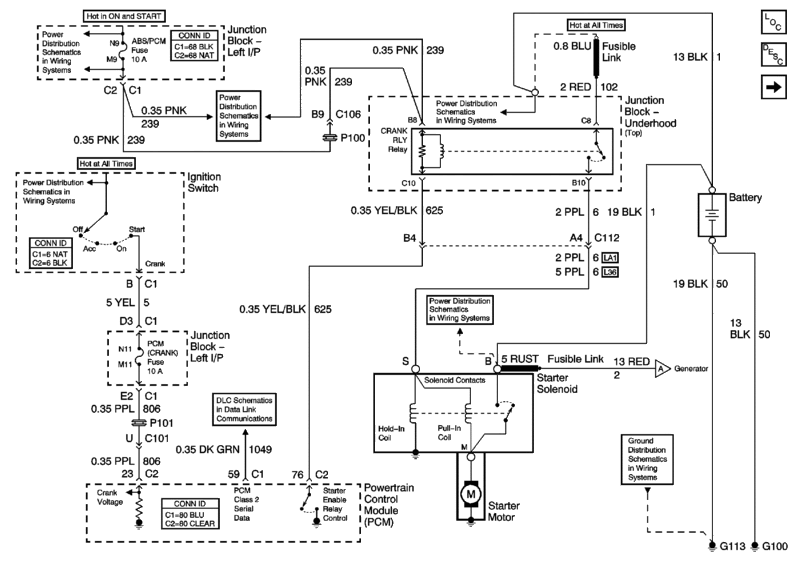

The cluster is functioning normally as far as all of the lights turning off except for the check engine light when the key is turned to crank. Check the fuses and the crank relay shown in this schematic:
http://i36.photobucket.com/albums/e50/twabelljr/Impalastart.gif
Swap the relay with another with the same nimber for a quick test. May just be the relay.
With the crank relay removed from the underhood junction block, test light to ground, there should be power on 2 terminals with the key in run. With test light to power, one terminal should be grounded (through the starter) and the light should illuminate, the other terminal should ground in crank position and illuminate the test light (starter enable PCM ground). Look at the diagram on the side of the relay, and jump the switch terminals, usually 87 & 30, diagonal from each other at the fuse block and see if the starter turns. Check for power at the PCM Crank fuse with the key in the crank position. If all checks good except the PCM starter enable ground, you may have a security problem as the theft deterrent for this vehicle disables crank and fuel.
